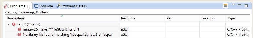

elyomartinez
Hello everyone
I am trying to build the egui demo using CW 10.5 and MQX 4.0.2, so i am using some of the files above (egui 3.0 v1.zip).
I have imported projects to CW (BSP project, PSP project, etc.) following instructions of page 7 in the file http://www.freescale.com/files/soft_dev_tools/doc/support_info/FSL_MQX_Getting_Started.pdf
But when i try to build all i got these two errors.
It is the first time i use this version of codewarrior, so i don't know if i am missing something or if i have done something wrong.
Thank you in advance for your reply
Elyo
10,680 Views
LuisCasado
The Project can't find the MQX libraries. bsp.a, psp.a aren't found. If you have built the MQX libraries for K70 and CodeWarrior, you must review the paths in your eGUI project. Some projects use environment variable "MQX_PATH”, but can also be defined with a variable in your project settings, MQX_LOC or similar.

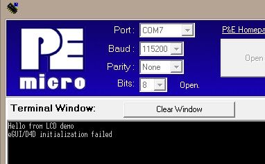

elyomartinez
Hello, this is what i get form serial port
I am using user_config.h with modifications
MQX_USE_LWTIMER          1
MQX_ROM_VECTORS        0
I am also having a problem while applying MQX 4.0.2.1 and MQX 4.0.2.2 patches, i have unzipped the patch files in the MQX folder and this is what i get:
10,680 Views
LuisCasado
The error in the serial port is coming probably because fails installing the interrupt vector or init the timer. I suggest to rebuild bsp and psp with the modified user_config.h. And you could use MQX 4.1.1

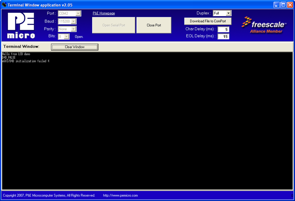

donikuy
I have managed to debug the project as well but manage to receive the below messages:
Hello from LCD demo
eGUI/D4D initialization failed
Any ideas on how i could initialize the gui or how to trace the problem?
10,680 Views
LuisCasado
Are you building the MQX libraries with the user_config.h provided?
Try to debug into the code, if the initialization fails installing the LCD isr is because you're missing  #define MQX_ROM_VECTORS          0

donikuy
Hi Luis,
Thank you for your reply. I am building with the user_config.h from the project and i have defined the MQX_ROM_VECTORS     0 . I have removed the coment for the LCDC_DEBUG which is defined as 0 and made other little changes but still haven't found the issue. How can I run debug the code so that i can follow each instruction to see where the D4D LCD Init fails? Thanks!
10,680 Views

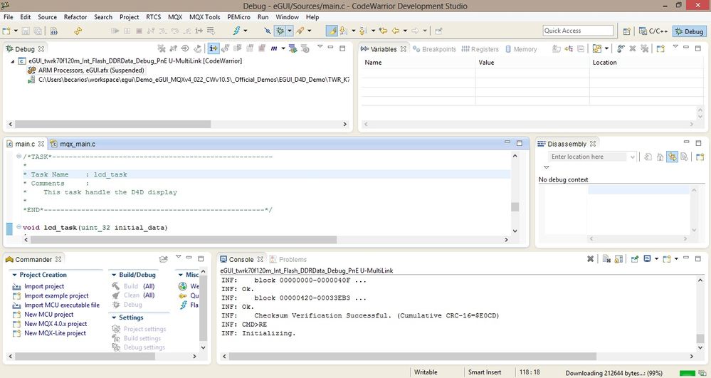

randybulloch
Hi Yiber,
Are you using the twrk70f120m_Int_Flash_DDRData_Debug configuration? I was using twrk70120m_Int_Flash_SramData_Debug configuration, and it showed the error you have because the application did not have enough ram.
10,680 Views
LuisCasado
Yes, you have to use twrk70f120m_Int_Flash_DDRData_Debug configuration. Frame buffer is in DDR.
Luis
10,680 Views
donikuy
Yes, I am using twrk70f120m_Int_Flash_DDRData_Debug configuration and i manage to debug the board and get the above messages from the terminal, where D4D FALSE shows the state of D4D_Init function. Do you still think this has anything to do with the mqx installation? Could you also please send me a demo project for TWR_K70_LCD which you have successfully debugged in the past? Thank you very much for your help!
10,680 Views
randybulloch
When debugging you can step into the D4D_Init() procedure with F5 (Step Into) and follow the code through each procedure with F5 until you reach the error.  This should help determine the cause of the error.

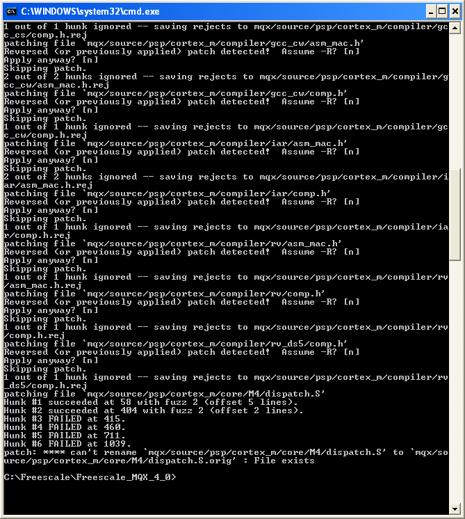

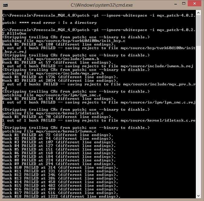

donikuy
Sorry for asking too many questions but i now think the patch file is the problem because the project requires mqx4.0.2.2. While i am trying to add the patches to the mqx i get the below failures on the comand window:
Any idea why that comes up?
10,680 Views
LuisCasado
Just unzip the patch file in the MQX folder as said in the Release notes:
Extract the content of the zip file to the MQX 4.0.2 installation. The default installation directory is C:\Freescale\Freescale_MQX_4_0.
Luis
10,680 Views
