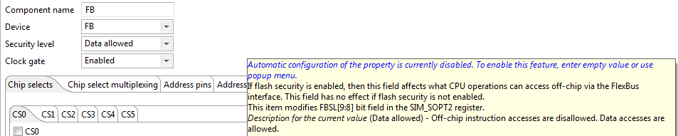

I'm using a Tower with Kinetis K65, and I managed some time ago to configure SDRAM and use it with not too much problems, but today I faced a very very strange issue.
Everything works fine when FTFE_FSEC is 0xFE, but when I change SEC bits to != 0b10, the device doesn't boots up.
Of course, under this circumstance I can't debug, as on-board flash is read-protected. After several tests, I found that when I disable the SDRAM initialization, the device works fine.
Anyone has seen something similar before? Can you give any indication of what can be wrong?
I have tested several combinations of FTFE_FSEC[SEC] bits. No positive results when flash external read is disbled.
This is my latest setting (in startup_MK65F18.S) :

Hi Carlos,
This is related to the security level on Kinetis. Please see following description from K65 RM.
9.3.1 Security interactions with FlexBus and SDRAM controller
When flash security is enabled, SIM_SOPT2[FBSL] enables/disables off-chip accesses
through the FlexBus and the SDRAM interfaces. The FBSL bitfield also has an option to
allow opcode and operand accesses or only operand accesses.
Default configuration for FBSL disallow Flexbus or SDRAM access. So you need to program FBSL to appropriate configuration.
Hao

Thank you, Hao, for your answer!
I found the place to configure this setting in ProcessorExpert (in FB component)
Configuring FBSL to the desired value solves the issue. Now I'm able to access SDRAM data with internal flash protection.
Thank you for your precise answer :smileyhappy:
