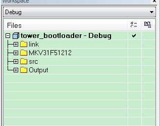

I have tested this now with a MK22F51212 Tower and this MKV31.  The K22 worked just fine.  I basically followed the attached Demo App User's Guide using both boards.  The bootloader itself flashes properly to both.  I am able to use blhost.exe with both and use the get-property 1 command and get a valid response from both.  The issue lies with Figure 10, Section 5.7.  I set the image and offset for the two boards (I am sure to use the correct led_demo binary for the proper eval board) and upon pressing update, the K22 erases the flash and writes the led_demo image and works properly while the KV31 can not get past erasing flash and instead I am greeted with "No response packet from target device.".

Hi Steven,
I was wonder if you can share the version of TWR-KV31F120M and specific product number of the KV31.
And I'd also like to know which line of code stucks in when you debug the tower_bootloader demo from the Kinetis_Bootloader_1_2_0.
I'm looking forward to your reply.

Steven
There is a KBOOT binary for the TWR-KV31F120M (and an application) at http://www.utasker.com/kinetis/TWR-KV31F120M.html
Check that it works on your board to ensure that you have no HW problem.
