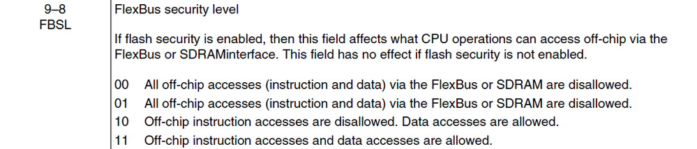

Hi Carlos,
This is related to the security level on Kinetis. Please see following description from K65 RM.
9.3.1 Security interactions with FlexBus and SDRAM controller
When flash security is enabled, SIM_SOPT2[FBSL] enables/disables off-chip accesses
through the FlexBus and the SDRAM interfaces. The FBSL bitfield also has an option to
allow opcode and operand accesses or only operand accesses.
Default configuration for FBSL disallow Flexbus or SDRAM access. So you need to program FBSL to appropriate configuration.
Hao

cgarcia1
Thank you, Hao, for your answer!
I found the place to configure this setting in ProcessorExpert (in FB component)
Configuring FBSL to the desired value solves the issue. Now I'm able to access SDRAM data with internal flash protection.
