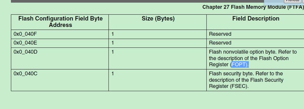

jay_heng
Hi Daniel,
Please check the value of offset 0x40d in your LED image (.bin format) to see whether it is equal to 0x3D (For detail , please refer to 27.3.1 Flash Configuration Field Description and 6.3.2 FOPT boot options in KL03 RM), this value will be loaded into FTFA_FOPT register automatically after reset.
  the value 0xFF, 0xFD means device will always boot from ROM (0x1c00_0000)
  the value 0x3F means device will always boot from FLASH (0x0000_0000)
  the value 0x3D means device will boot from ROM if BOOTCFG0 pin (NMI) asserted, otherwise, device will boot from FLASH. Note: NMI pin is sampled at the end of reset (when reset pin negates).
Jay

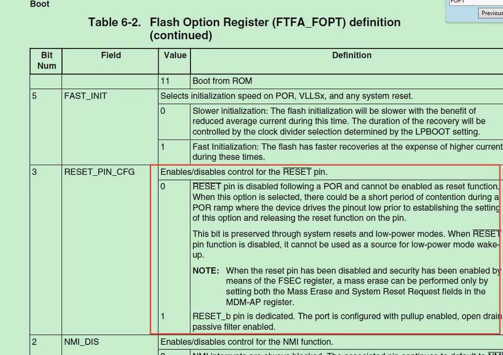

kerryzhou
Hi Daniel,
  1. If you have the JLINK, you can use JLINK commander to check it, if the JLINK commander can find the core through SWD interface, your chip is still alive.
2. PTA1 is the reset pin, it is in default as RESET_B function, you can't change it by the PORT mux directly, I suggest you choose other pin as the LED output pin, eg, PTA5.
Wish it helps you!
If you still have question, please let me know!
Jingjing
3,555 Views

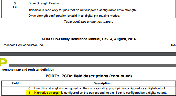

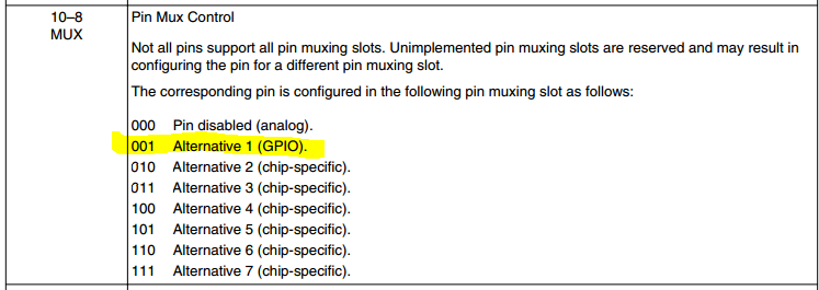

dsam1
Jingjing,
Thanks for your help. I don't have a JLINK device so I guess I'm stuck there.
I'm still confused about the IO. I included the line PORTA_PCR1 = 0x143; to convert PTA1 to a GPIO. Did I select the wrong bits? According to the reference manual, this is how GPIO function is selected on Port A Pin 1.
0x143 works out to setting bits 8, 6, 1, and 0.
3,555 Views
kerryzhou
Hi Daniel,
    PTA1 is the special pin, it is in default as RESET_b function:
    If you want to disable the reset function , you should modify the FOPT register, this register data is put in flash Address 0x40d
So, if your pins are enough to use, I suggest you use other pin as the GPIO pin, don't choose SWD pin, NMI, RESET pin.
Wish it helps you!
If you still have question, please contact me!
