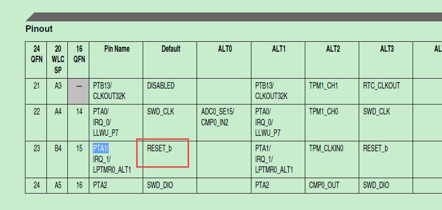

Hi all, 2 problems I'm having:
I have a MKL03Z8VFG4 that I soldered to a QFN16 breakout board. I plugged this into a breadboard. I put a decoupling cap between VCC and GND (and connect a linearly regulated 3.3V to it), put a pullup resistor on NMI_b, and put a pulldown button closer to the NMI_b pin so I can enter bootloader mode. I also connect a USB to 3.3V UART adapter's TX, RX, and GND to the board. This works for a while.
1. I rarely move stuff around on my desk, and I'm being very careful not to generate static (everything is grounded back to my metal case laptop), but eventually (a few hours to a few weeks) the chip will stop responding. The chip didn't pop or even get hot as far as I can tell. But when holding the button to put it in bootloader mode, then using the KinetisFlashTool to 'connect' to the bootloader, it will not respond. I don't think anything is running, since on the chip's TX pin I can see the cross-talk noise (a few millivolts on the adapter's RX) from my USB UART adapter's TX signal (they happen synchronously, I checked with a scope). Is there any other way to see if my chip is still alive?
2. I've been having a hell of a time getting the minimum program working, while the chip is still alive. See code below. I'm just trying to blink an LED! (rather, toggle an output... I just use my scope and probe the pin in case the chip can't support the 1 mA of LED current.)

dsam1
Kind of solved it.
One issue is that I think I was killing chips. These things are more sensitive than I'm used to!
Second is that for some of the time, I had reset attached to an LED, which didn't let the chip reset and therefore connect to the bootloader. Once I fixed this, some chips came back alive and some didn't.
Thank you NXP for helping me debug.

kerryzhou
Hi Daniel,
  1. If you have the JLINK, you can use JLINK commander to check it, if the JLINK commander can find the core through SWD interface, your chip is still alive.
2. PTA1 is the reset pin, it is in default as RESET_B function, you can't change it by the PORT mux directly, I suggest you choose other pin as the LED output pin, eg, PTA5.

kerryzhou
Hi Daniel,
    PTA1 is the special pin, it is in default as RESET_b function:
    If you want to disable the reset function , you should modify the FOPT register, this register data is put in flash Address 0x40d
So, if your pins are enough to use, I suggest you use other pin as the GPIO pin, don't choose SWD pin, NMI, RESET pin.
