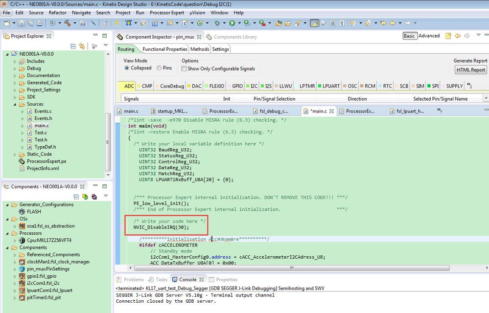

    After debugging with JLINK tool, we have found the factor which have caused the LPUART can't receive the data, because the code enter FlexIO interrupt handler.
    So, now please disable the flexIO interrupt in your main code:
    NVIC_DisableIRQ(30);
  Please do it like this:
After the modification, then download the code to your KL17 chip, and try it again, you will receive the data with LPUART.

Hi Samuel,
    Yes, I also test it on the FRDM-KL43 board, and create a PE KDS KL17Z256VLH4 project, I have reproduced your LPUART receive problem after enable BCA LPUART .
    LPUART used pin is PTA1 and PTA2.
    Did your customer board KL17 also use PTA1 and PTA2?
    Now, I am checking it, whether it is just the PE project problem, and need to communicate with other colleagues about this question. If I have any progress, I will let you know as soon as possible.
   Please wait patiently.

It's a great news you have reproduced the problem! At  moment I believed to become crazy...so now as you have the problem in your hands, you will can find a solution!
To reply to your question, yes my board uses PTA1 and PTA2.
For information I have 2 cases created with the support about bootloader:
- One for the subject of this topic, as you have reproduced the problem it can close I think.
- Another one with the call of ROM bootloader in my application with his AN  Call ROM Bootloader from customer application with FRDM-KL43Z board
In this one I explain that I'm able to call the ROM bootloader in my application and reprogram it with the Kinetis Upater, but just one time. After the first reprogramming, the program restarts correctly but when I call the Bootloader one more time, the Kinetis Updater is unable to reconnect to the bootloader.
I know each thing at each time, but I prefer to expose it as it's concern the bootloader, maybe there's a link with the problem you treat actually.
