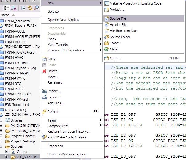

1) I'm trying to understand tutorials for k40 and in all tutorials i saw 'k40_TOWER_BOARD_SUPPORT.h'/'k40_TOWER_BOARD_SUPPORT.c'
where can i find that sources?

Answering your first question, if you can´t find those files you can create them and add them to your project:
  1. Check this link K40: Blinking LED - The Freescale Cup Wiki  where you can find the code for k40_TOWER_BOARD_SUPPORT.h and K40_TOWER_BOARD_SUPPORT.c
  2. In your project right click sources-->New-->new folder, then give a name to the folder. (e.g K40_SUPPORT).
  3. Right click on the new folder(K40_SUPPORT)-->new-->source file. Name it as K40_TOWER_BOARD_SUPPORT.c
  4. To the same of the last step, but now choosing header file and name it as k40_TOWER_BOARD_SUPPORT.h
  5. In .h file paste the code form the link and do the same with .c file. Copy the code respectively.
  6. Now you just need to write the #include files in each one.

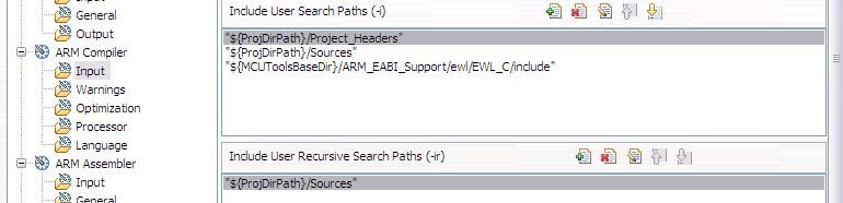

  8. Add paths for the new folder in project properties. right click-->properties
  9. In the tree on your left  C/C++ Build-->Settings then add the paths on ARM Compiler-->Input. Add the path for Source folder "${ProjDirPath}/Sources"adding paths 2.JPG
  10. Apply and Now compile.
Let me know if you have any problems.
