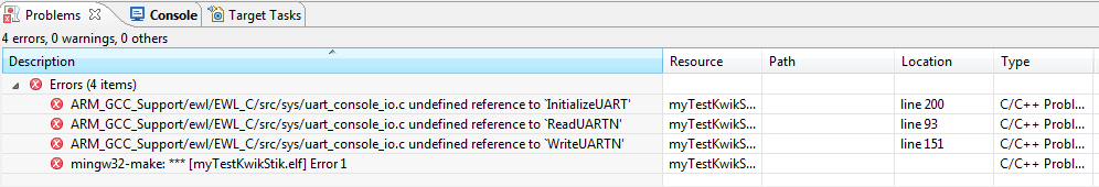

I have some troubles with the KwikStik (v5). I already tried different tools (IAR Embedded Workbench, Atollic True Studio, Code Warrior) but I always get some error when I want to use the printf function.
I just created a new project in CodeWarrior and just added a simple line printf("Hello World \r\n"); and #include <stdioi.h>.
I always get the error when I try to compile:
There must be a Problem with the UART?!

These functions must be provided by the user for printf to work.
You need to set up a UART and then provide these functions so printf's "go some where".
You could use processor expert to set up a serial port.
I am sure there is support for the uart, but you need to add the file, I suggest you ask freescale tech support to define this.
