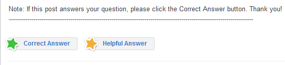

I am logged in and there is no button like you show anywhere on the page.
3,347 Views
PHXFAE
Where is the correct answer button.  I don't see it.
3,348 Views
PatriciaTeran
You have to Log in, in order to see it. It should be right below the post with the answer, like this
