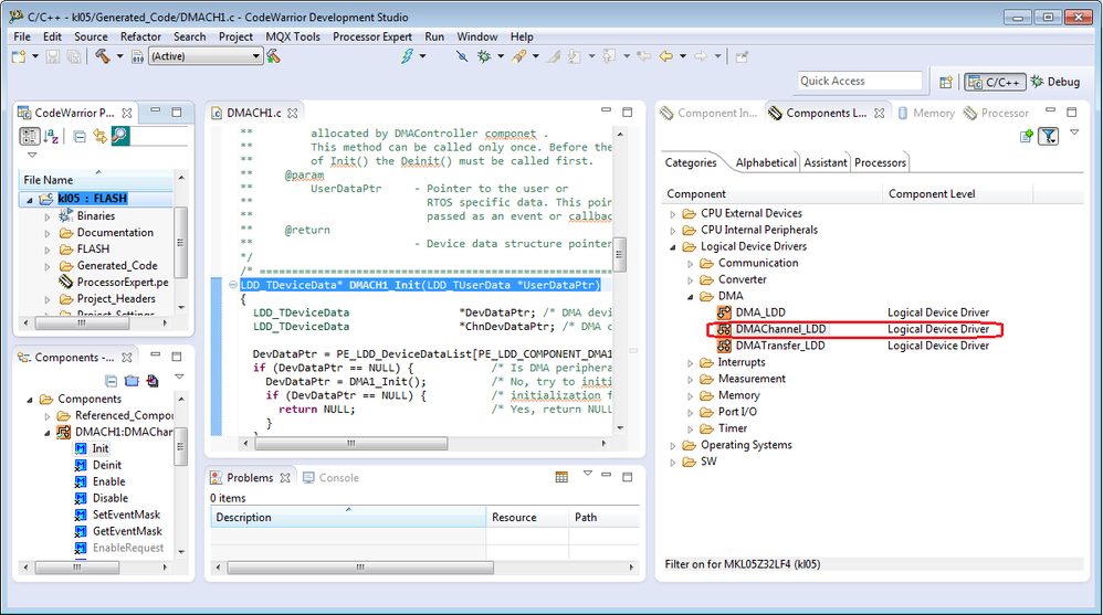

MVa
Hi Carlos,
  try to use DMAChannel_LDD component instead of DMATransfer_LDD. It doesn't require so much memory resources.
