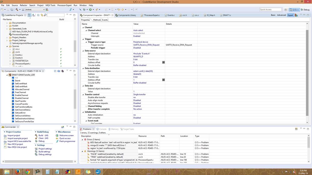

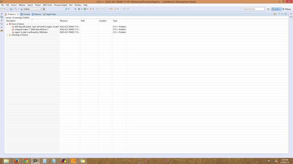

I am using Codewarrior 10.5. while compiling a program in KL05Z32VLF4 I was getting the following error. I didn't get what the issue is and how to overcome this. Kindly help.
while evaluating I found out that in the below code when I am commenting "DMAT1_EnableChannel(dmap);" the error is not coming. I think it has something to do with DMA.

I am using the following DMA Settings

That kind of errors means that the linker is not able to allocate your code into the flash, since the code size is bigger than the size specified in the linker file, which usually is the max flash available on your MCU. Removing that function from your code, makes it to not being linked, hence the code size is smaller and fits.
In this case, it seems your application won't fit the 32Kb available on your MCU.

Hi Carlos,
  try to use DMAChannel_LDD component instead of DMATransfer_LDD. It doesn't require so much memory resources.
