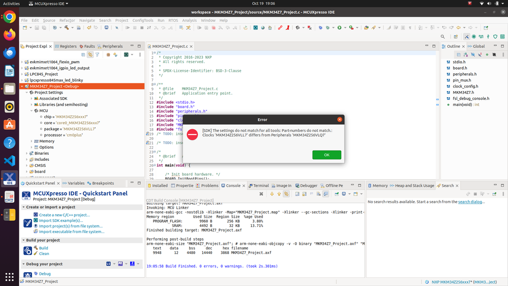

Hi team,
I've followed this link, for working with Custom HWs, where the SDK for LPCXpresso845MAX in imported and used to create a new breakout board.During the process, the device package has been modified/changed to suit the application. It worked perfectly for me without any glitches.
Similarly, I imported both SDK_2_14_0_TWR-KM34Z75M & SDK_2_14_0_MKM34Z256xxx7  -- and when i changed the default device package to MKM34Z256VLL7 (where my custom board is gonna be build based on this package), the project build without any error. But, when I go for the config tools- pin modifications in project I'm getting the below error.
Then to create a project for MKM34Z256VLL7?
2,068 Views
GanesanGuru
The issues has been rectified, once we enable the config tools with older MCU package and then switching to our necessary package (MKM34Z256VLL7).
