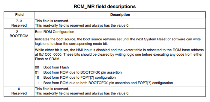

I'm using the K82FN256 and want to use the BOOTCFG0 pin for booting. Is this BOOTCFG0 active HIGH or active LOW (asserted by logic 1 or 0)?

Hello Jan,
Based on the following table of the reference manual.
We can know that the pin is active high, asserted by logic 1.

victorjimenez
Hello Jan,

Hi Victor,
Thank you! Apparently putting a high value at the pin will result in a 1 at the register. I missed that point.
