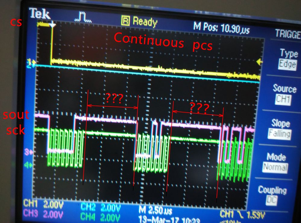

HI,
I am using mk22fn512 SPI1/SPI0 to send a series of data,Let SPI/SPI0 work in the loopback and continuous sck and continuous pcs mode.I found that when the SPI bus transmits data, each SOUT will have a certain delay after the completion of a single byte of data,  which causes the slave device to be unable to determine the received data.

Continuous or discontinuous mode, SOUT does not have continuous output data. What is the reason?

The obvious answer is that your data-load code-sequence is unable to 'keep up' with the TX byte-rate.  Slow your SPI clock, and/or clean up the code sequence. At BR=30 you've got 240 bus clocks per byte, or (presumably) 480 CPU clocks.  Seems like a lot, but clocks are also easy to 'waste' ---- looks like you might be taking over twice that time?
You might also consider loading 16-bits per SPI transaction, rather than 8.
You will probably also have to make sure you are fully utilizing the SPI FIFOs so that the TX hardware always has a byte 'ready to go' on the very next SPI clock.  If you wait for each 'TX complete' before even loading the 'next' you will surely skip a clock.
Can you capture your full sequence of 'PUSHR' values in a little debug-array, and show us that after a full message?
