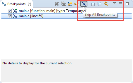

It seems that since I have installed the latest updates (a couple days ago), I have not been able to set breakpoints in the Windows GUI. When I click on the bar as normal to set a breakpoint, I get this icon. 48678_48678.pngpastedImage_0.png
I am able to right click on the line a perform a "Run to this line." But that's about it.
Any hints as to what I'm doing wrong?

Hi David,
I think you have 'Skip all breakpoints' enbled:
See Skipping Breakpoints | MCU on Eclipse

davepfaltzgraff
Senior Contributor I
Right on!
I wasn't even aware of such an option. I've always just deleted all breakpoints when I needed that. (Then reset them again!)
