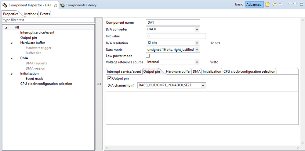

Hi All,
   I am using KDS IDE and K22F Kinetis board. I want to implement simple Digital - Analog converter. I am trying using Processor Expert. The configuration done is as shown below.
I add "DAC_LDD" component. Since the MCU supports only 1 DAC, i.e "DAC0_OUT/CMP1_IN3/ADC0_SE23".
I use 12 bit resolution as it supports 12-bit.
No interrupts.
No hardware buffer
No DMA
Enable in init code
Autoinitialisation.
In main loop, I call
  for (;;) {
   Error = DA1_SetValue(NULL, 4095U);                    /* Set converter output */
Value of Error is 0 which mean setting value was successful. I also see all the registers are set properly. I try to measure value on the DAC_output pin using multimeter. I expect the value to be 3.3V. But I am getting few milli volts which means DAC is not working properly. Can some one please tell me if I am missing something. Thanks a lot in advance.

Hi Vishal,
Please set the voltage reference in the DAC component to "external" from "internal".
I also added in a delay loop (polling) so it doesn't change too fast as I used a Voltmeter to watch the DAC output.
David

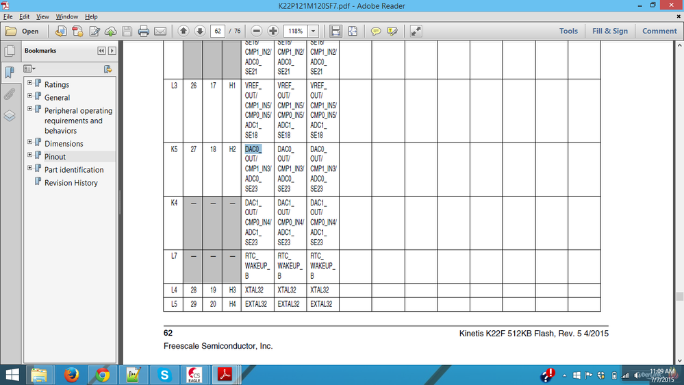

vishalgirisagar
Hi David,
   There is no need to configure PCR register MUX because DAC is default function on this pin. I have attached a pic from data sheet below.
Also Port clock is enabled in the componenet section. Screenshot attached below.

Hi Vishal,
David
4,701 Views
vishalgirisagar
Hi David,
  Thanks a lot. That works. I really am very thankful to you.
