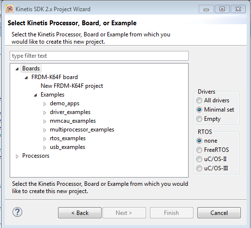

Project Wizard is supposed to be able to create a project from an example.
But, it doesn't show any example, nor provide a way to point it an an existing project?
Here's what I see:
The title says it should show examples, but none are listed.
How do I get this to work??? Or is this a bug?
Thanks!

MarekTrmac
Hi Dave,
can you check if there is file boards\frdmk64f\demo_apps\hello_world\example.xml in your SDK package?
NPW 2.0.1 is the latest version.
Marek

MarekTrmac
Hi Dave, you have old SDK package that does not support cloning examples.
> Hi Dave,
> please download latest version of KSDK 2.x K64F package from kex.nxp.com.
> Regards
> Marek
New Kinetis SDK 2.x Project Wizard    2.0.1.201610200920    com.nxp.feature.npw4sdk.feature.group    NXP Semiconductors
This is the latest version of New Project Wizard for SDK 2.x
Marek

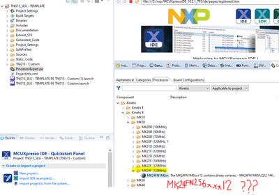

Richard011
Hello Marek,
How can I find the processor MK24FN256xxx12 in the MCUXpresso IDE ?
I'm not seeing it !!!
Ricahrd
12,451件の閲覧回数
ErichStyger
Specialist I
Did you download the SDK from the https://mcuxpresso.nxp.com?
Because I see it listed there:
12,441件の閲覧回数
Richard011
Hello @ErichStyger ,
I have installed the sdk, but, went I try to replace a processor in a project I have by this MK24FN256xxx12, I can't find it. Also, when I want to create a new processor expert project with the cpu MK24FN256xxx12, it doesn't work.
What could be the solution please ?
Richard
MK24FN256CDC12_Modifying_a_project_for_it.PNGMK24FN256CDC12_Modifying_a_project_for_it.PNG
MK24FN256CDC12_Creating_a_project_with_it.PNGMK24FN256CDC12_Creating_a_project_with_it.PNG
12,433件の閲覧回数
ErichStyger
Specialist I
Hi Richard,
I don't use the MK24FN, so cannot comment or help much on that device.
I see from your screenshot that you are using Processor Expert. Keep in mind that Processor Expert is legacy and not supported by NXP any more, so no surprise to me that some processors are not supported (only the ones which are older a few years). Additionally, the NXP MCUXpresso SDK does not support and does not come with any support for Processor Expert, so using that won't help.
In essence: Processor Expert is a dead end in most cases, and you have to stick with the processors supported in there, and don't expect any new/other device support.
What I did is that I transformed my most used Processor Expert components and source code into the McuLib, which now is generic and supports both Processor Expert and SDKs from different vendors.
Going forward, I think you have use the NXP MCUXpresso SDK if you really want to use that device.
I hope this helps,
Erich

MarekTrmac
All the examples will be available in the wizard, see attached picture
