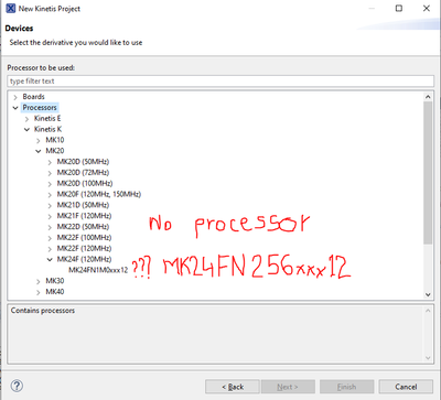

Richard011
Hello Marek,
How can I find the processor MK24FN256xxx12 in the MCUXpresso IDE ?
I'm not seeing it !!!
Ricahrd

Richard011
Hello @ErichStyger ,
I have installed the sdk, but, went I try to replace a processor in a project I have by this MK24FN256xxx12, I can't find it. Also, when I want to create a new processor expert project with the cpu MK24FN256xxx12, it doesn't work.
What could be the solution please ?
Richard

ErichStyger
Specialist I
Hi Richard,
I don't use the MK24FN, so cannot comment or help much on that device.
I see from your screenshot that you are using Processor Expert. Keep in mind that Processor Expert is legacy and not supported by NXP any more, so no surprise to me that some processors are not supported (only the ones which are older a few years). Additionally, the NXP MCUXpresso SDK does not support and does not come with any support for Processor Expert, so using that won't help.
In essence: Processor Expert is a dead end in most cases, and you have to stick with the processors supported in there, and don't expect any new/other device support.
What I did is that I transformed my most used Processor Expert components and source code into the McuLib, which now is generic and supports both Processor Expert and SDKs from different vendors.
Going forward, I think you have use the NXP MCUXpresso SDK if you really want to use that device.
