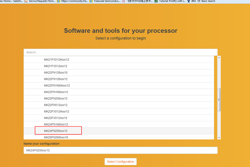

Hello, I need to include processor MK24FN256xxx12 for my project and I couldn't find it under the processors in devices. The only processor I was able to use was MK24Fn1M0xx12 but when I tried to load my code in internal flash, I get errors. However I was able to run the code if I download it in RAM. I assume this has to do with having different variant of the board.
How can I add MK24FN256xxx12 in the project?

Hello Rupesh,
Please refer to this thread to download and install the KSDK1.3 for MK24FN256xxx12:
Using Kinetis Design Studio v3.x with Kinetis SDK v2.0
then when you create project , you can see this option.
Hope it helps
