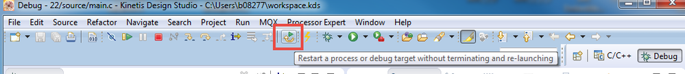

in addition, during debugging code, we can restart a program by click on restart button as below:
it can restart a progress or debug target without terminating and re-launching.

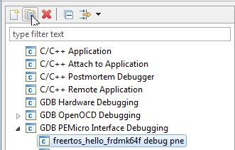

Hi David,
In the Debug Configurations...  dialog box, I simply Duplicate the working PEMicro configuration and append a new name.
Ex:

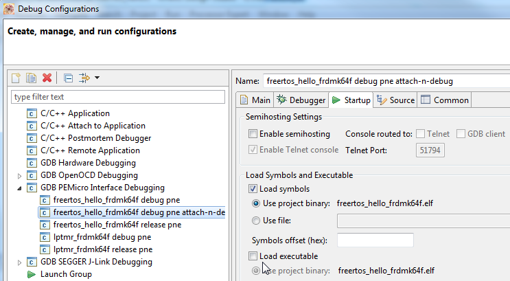

Then I goto the Startup tab, and de-select the "Load executable" check box so the flash is not erased and reprogrammed.
Ex:
Click Apply, and then Debug.
Now this configuration will reset and restart your application each time.
Same process works with JLink too.
