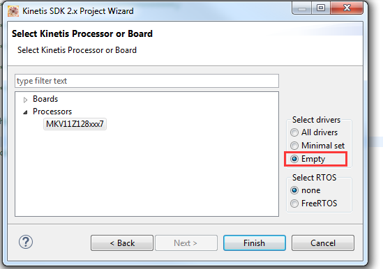

We are interested in using the KV11, but it appears in KDS 3.2 that it only supports KV10.  While the two are similar and we could alter things to support KV11, are there plans to add KV11 to make a basic project without Processor Expert or KSDK?

Hello David,
You can download the KSDK2.0 for MKV11   "SDK_2.0_MKV11Z128xxx7",
the detail steps for download please refer to :How to: install KSDK 2.0
If you don't want to use the KDSDK drivers , you can select "Empty " when create proect :
Hope it helps
