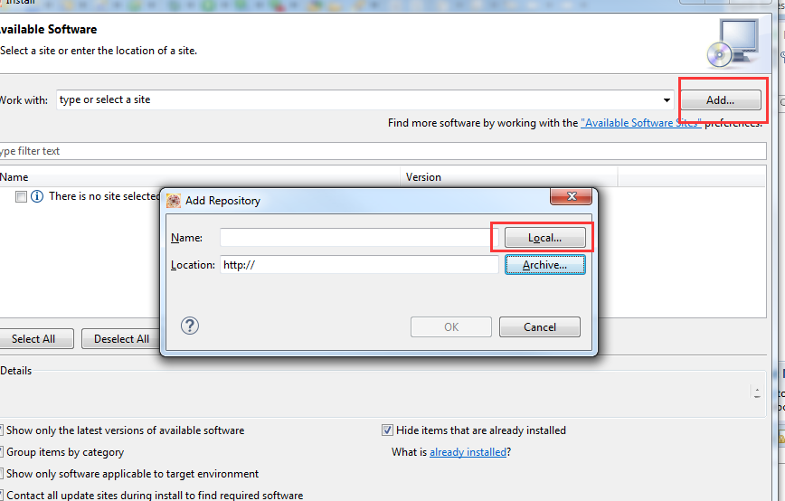

Hello ,
The workaround is :
- Download the .zip file from GNU ARM Eclipse Plug-ins Releases
- Then install it in KDS : help-> install new software -> Add->
select the .zip file to install .
Hope it helps
