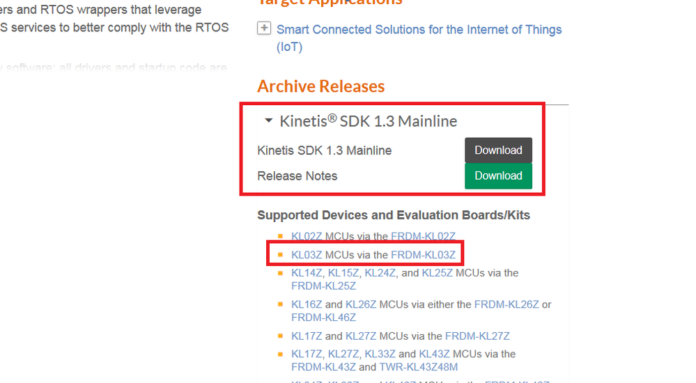

I'm a beginner with Kinetis design Studio. I have a FRDM-KL03z board and want to use Processor expert when I develop code. But when I have setup a project with KL03z as target then i can't find it in processor expert. How can I do that?.
I can see KL02z and KL04z but not KL03z.

The KSDK 1.3 mainline release contain the support of the KL03. See the following link:
http://www.nxp.com/products/wireless-connectivity/2.4-ghz-wireless-solutions/ieee-802.15.4-plus-ble/...
and navigate to the Kinetis SDK 1.3 Mainline download link:
To work with KL03+processor expert, we need:
1. install KDS3.2
2. install KSDK1.3 mainline.
3. Do update from KDS IDE menu "help", "check for update".
then you will see KL03 and processor expert available. see attached video.

Hi Per,
Please goto the Freedom frdm-kl03 product page at following link:
FRDM-KL03Z|Freedom Development Platform|Kinetis MCU|NXP
Click the Getting Started tab and follow instructions to setup tools and run examples from KSDK_1.3.
Note KSDK_1.3 will work with PE in KDS.  But newest KSDK_2.0 does not support PE.  So when installing tools make sure you install the KSDK_1.3.
Then for working with PE look here:  How to start with KSDK

actually, I confront to the same problem. I have followed your instructions and watched the video. The KL03 is missed.
I only see KL02z and KL04z but not KL03z when I create the new project to choose the processor!
