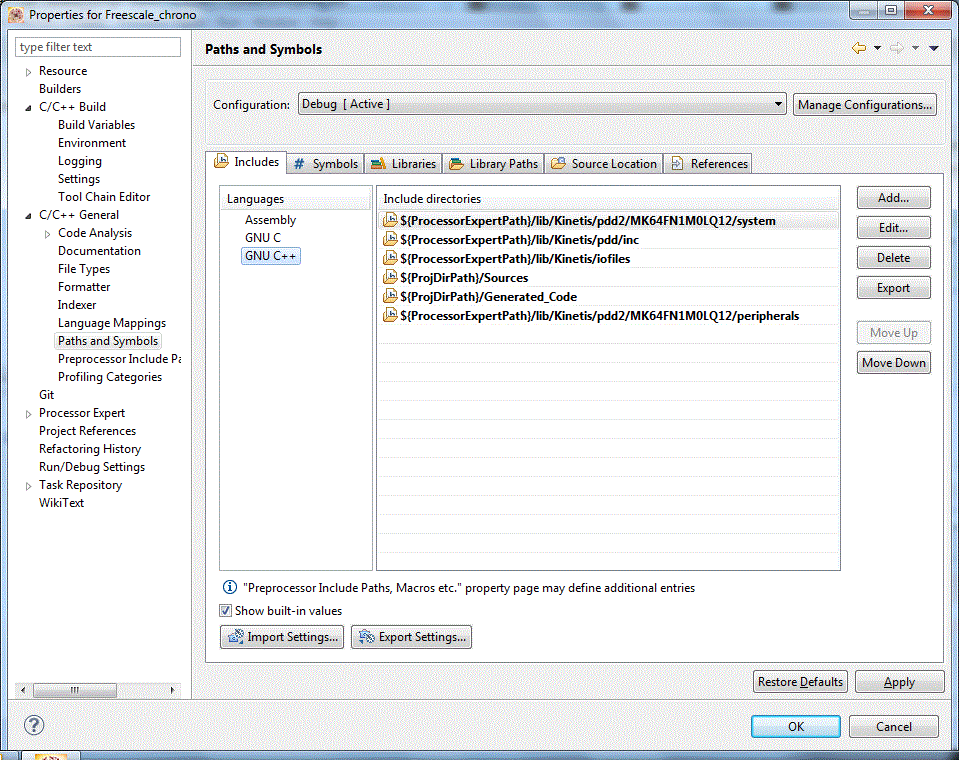

Good morning,
For the last days I am struggling with a problem with KDS.
I developed a C-Project for the FRDM-k64f board, using KDS and Processor Expert (I started a KDS project).
Now I need to add a C++ class to my project.
In order to do so, I renamed the main.c to main.cpp, and added the include directive as following:
but I have a problem:
The compiling of the files is successful, but the linker gives error to some functions (I think for the linking file order).
Is someone able to help me?
Thank you in advance.

'Building target: Freescale_chrono.elf'
'Invoking: Cross ARM C++ Linker'
arm-none-eabi-g++ -mcpu=cortex-m4 -mthumb -mfloat-abi=hard -mfpu=fpv4-sp-d16 -O0 -fmessage-length=0 -fsigned-char -ffunction-sections -fdata-sections  -g3 -T "C:/Users/Toshiba/workspace_kds/Freescale_chrono/Project_Settings/Linker_Files/ProcessorExpert.ld" -Xlinker --gc-sections -L"C:/Users/Toshiba/workspace_kds/Freescale_chrono/Project_Settings/Linker_Files" -Wl,-Map,"Freescale_chrono.map" -nanolibc -o "Freescale_chrono.elf"  ./Static_Code/System/CPU_Init.o ./Static_Code/System/Peripherals_Init.o ./Static_Code/System/Vectors.o  ./Static_Code/Peripherals/LPTMR0_Init.o ./Static_Code/Peripherals/USB0_Init.o  ./Sources/LCD/UTFT.o  ./Sources/BT_serial.o ./Sources/Battery.o ./Sources/Chrono.o ./Sources/CommandHandler.o ./Sources/Events.o ./Sources/RTC.o ./Sources/Serial.o ./Sources/USB_serial.o ./Sources/UTIL64b.o ./Sources/main.o  ./Project_Settings/Startup_Code/startup.o  ./Generated_Code/AD1.o ./Generated_Code/ASerialLdd1.o ./Generated_Code/BT1.o ./Generated_Code/BUZZER.o ./Generated_Code/BUZZERTIMEOUT.o ./Generated_Code/CDC1.o ./Generated_Code/CS1.o ./Generated_Code/Cpu.o ./Generated_Code/FLASH1.o ./Generated_Code/LCD_CS.o ./Generated_Code/LCD_DB0.o ./Generated_Code/LCD_DB1.o ./Generated_Code/LCD_DB10.o ./Generated_Code/LCD_DB11.o ./Generated_Code/LCD_DB12.o ./Generated_Code/LCD_DB13.o ./Generated_Code/LCD_DB14.o ./Generated_Code/LCD_DB15.o ./Generated_Code/LCD_DB2.o ./Generated_Code/LCD_DB3.o ./Generated_Code/LCD_DB4.o ./Generated_Code/LCD_DB5.o ./Generated_Code/LCD_DB6.o ./Generated_Code/LCD_DB7.o ./Generated_Code/LCD_DB8.o ./Generated_Code/LCD_DB9.o ./Generated_Code/LCD_LEDA.o ./Generated_Code/LCD_RS.o ./Generated_Code/LCD_RST.o ./Generated_Code/LCD_WR.o ./Generated_Code/LED_B.o ./Generated_Code/LED_G.o ./Generated_Code/LED_R.o ./Generated_Code/PE_LDD.o ./Generated_Code/PhotoInt.o ./Generated_Code/Pins1.o ./Generated_Code/Rx1.o ./Generated_Code/SPI0.o ./Generated_Code/STRIP_LED_B.o ./Generated_Code/STRIP_LED_G.o ./Generated_Code/STRIP_LED_R.o ./Generated_Code/STRIP_LED_R_TIMEOUT.o ./Generated_Code/Serial1.o ./Generated_Code/Tx1.o ./Generated_Code/USB1.o ./Generated_Code/UTIL1.o ./Generated_Code/WAIT1.o ./Generated_Code/usb_cdc.o ./Generated_Code/usb_cdc_pstn.o ./Generated_Code/usb_class.o ./Generated_Code/usb_dci_kinetis.o ./Generated_Code/usb_descriptor.o ./Generated_Code/usb_driver.o ./Generated_Code/usb_framework.o ./Generated_Code/wdt_kinetis.o
./Sources/main.o: In function `main':
C:\Users\Toshiba\workspace_kds\Freescale_chrono\Debug/../Sources/main.cpp:157: undefined reference to `BT_SendString(unsigned char*)'
C:\Users\Toshiba\workspace_kds\Freescale_chrono\Debug/../Sources/main.cpp:159: undefined reference to `CDC1_App_Task(unsigned char*, unsigned int)'
C:\Users\Toshiba\workspace_kds\Freescale_chrono\Debug/../Sources/main.cpp:162: undefined reference to `CDC1_SendString(unsigned char*)'
C:\Users\Toshiba\workspace_kds\Freescale_chrono\Debug/../Sources/main.cpp:167: undefined reference to `BT_SendString(unsigned char*)'
C:\Users\Toshiba\workspace_kds\Freescale_chrono\Debug/../Sources/main.cpp:169: undefined reference to `CDC1_App_Task(unsigned char*, unsigned int)'
C:\Users\Toshiba\workspace_kds\Freescale_chrono\Debug/../Sources/main.cpp:172: undefined reference to `CDC1_SendString(unsigned char*)'
C:\Users\Toshiba\workspace_kds\Freescale_chrono\Debug/../Sources/main.cpp:177: undefined reference to `BT_SendString(unsigned char*)'
C:\Users\Toshiba\workspace_kds\Freescale_chrono\Debug/../Sources/main.cpp:179: undefined reference to `CDC1_App_Task(unsigned char*, unsigned int)'
C:\Users\Toshiba\workspace_kds\Freescale_chrono\Debug/../Sources/main.cpp:182: undefined reference to `CDC1_SendString(unsigned char*)'
C:\Users\Toshiba\workspace_kds\Freescale_chrono\Debug/../Sources/main.cpp:222: undefined reference to `USB_ceck_command(char*, unsigned char*)'
C:\Users\Toshiba\workspace_kds\Freescale_chrono\Debug/../Sources/main.cpp:224: undefined reference to `BT_ceck_command(char*, unsigned char*)'
C:\Users\Toshiba\workspace_kds\Freescale_chrono\Debug/../Sources/main.cpp:238: undefined reference to `USB_sendStart()'
C:\Users\Toshiba\workspace_kds\Freescale_chrono\Debug/../Sources/main.cpp:244: undefined reference to `BT_sendStart()'
C:\Users\Toshiba\workspace_kds\Freescale_chrono\Debug/../Sources/main.cpp:285: undefined reference to `USB_sendTimeLap(unsigned int, unsigned long long*)'
C:\Users\Toshiba\workspace_kds\Freescale_chrono\Debug/../Sources/main.cpp:291: undefined reference to `BT_sendTimeLap(unsigned int, unsigned long long*)'
C:\Users\Toshiba\workspace_kds\Freescale_chrono\Debug/../Sources/main.cpp:305: undefined reference to `USB_sendTimeLap(unsigned int, unsigned long long*)'
C:\Users\Toshiba\workspace_kds\Freescale_chrono\Debug/../Sources/main.cpp:311: undefined reference to `BT_sendTimeLap(unsigned int, unsigned long long*)'
C:\Users\Toshiba\workspace_kds\Freescale_chrono\Debug/../Sources/main.cpp:336: undefined reference to `BT_SendString(unsigned char*)'
C:\Users\Toshiba\workspace_kds\Freescale_chrono\Debug/../Sources/main.cpp:349: undefined reference to `BT_SendString(unsigned char*)'
C:\Users\Toshiba\workspace_kds\Freescale_chrono\Debug/../Sources/main.cpp:353: undefined reference to `BT_SendString(unsigned char*)'
C:\Users\Toshiba\workspace_kds\Freescale_chrono\Debug/../Sources/main.cpp:355: undefined reference to `CDC1_App_Task(unsigned char*, unsigned int)'
C:\Users\Toshiba\workspace_kds\Freescale_chrono\Debug/../Sources/main.cpp:358: undefined reference to `CDC1_SendString(unsigned char*)'
C:\Users\Toshiba\workspace_kds\Freescale_chrono\Debug/../Sources/main.cpp:366: undefined reference to `Battery_check(unsigned short*, unsigned int)'
C:\Users\Toshiba\workspace_kds\Freescale_chrono\Debug/../Sources/main.cpp:369: undefined reference to `BT_SendString(unsigned char*)'
C:\Users\Toshiba\workspace_kds\Freescale_chrono\Debug/../Sources/main.cpp:375: undefined reference to `SendBatteryData(unsigned short*)'
collect2.exe: error: ld returned 1 exit status
make: *** [Freescale_chrono.elf] Error 1

hunt
I solved my Issue.
If someone has the same problem, the solution is to use the extern "C" directive for the C functions used inside the .cpp file. Otherwise the linker (not the compiler), will give you the error.
Thank you anyway.
