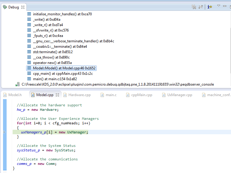

So I am using a K22F with 512K Flash and 128K RAM. Therefore, I have LOTS of RAM and should not in any way run out of RAM for the relatively little code I have developed so far, assuming the RAM space is adequately allocated.
Given that Processor Expert (PE) basically creates a main.c and you have a limited space to place your code, and my code is actually in C++, I make a call from main in the user section to a main.cpp that then instantiates all the C++ code, including prepping threads to execute once the OSA (FreeRTOS flavor) scheduler kicks in.
All of that has been running great. However, as I added a little more "meat" to some of the lower level classes, I began getting a trap in the new operator. Of course, you would suspect the new code, but the funny thing is that it allocates 4 classes before it barfs on the 5th one. It looks more like a possible memory allocation issue. Below is the code:

For what it's worth, here is the call stack when the trap fires:
Any thoughts or insights would be most appreciated. Perhaps I simply need to increase the amount of data allocated to the C/C++ heap if anyone knows where to change that? I was up late working on this and I am not looking forward to pulling my hair out all afternoon this fine Sunday. Rest assured, I will be Googling this ad infinitum, but wanted to put this out, especially before our dear friends in Europe went to bed.

OK, so HEAP_SIZE in ProcessorExpert.ld is only 0x0400! OUCH!
But of course, that is an auto-generated file. If only I can figure out HOW to change that somewhere in PE? Still looking...
2,128 Views
tharonhall
Bingo! Under Processors in PE Panel select the CPU, then Component Inspector, Build Options tab, then the Generate linker file tab. :smileyhappy:
However, the code is trapping in exactly the same way even though I tripled the stack size and increased the heap size by several times. :smileysad:
Any thoughts on another approach to debugging this? Is there a compelling argument for doing this using from within an OSA/FreeRTOS thread instead and using the OS heap?
???- Any tricks to knowing exactly what the new operator is barfing on? Since that is in a library, I don't know that I have visibility into what is going on there. :smileysad:

OK! Finally. It looks like in my effort to address the problem initially, I upped the OSA/FreeRTOS heap without also upping the linker heap. Therefore, there really wasn't enough memory for FreeRTOS to pull it's own heap from the general heap. :smileyhappy: While the small-ish heap may have been the initial heap, not increasing the C heap along with the FreeRTOS heap probably prolonged the pain. :smileysad:
