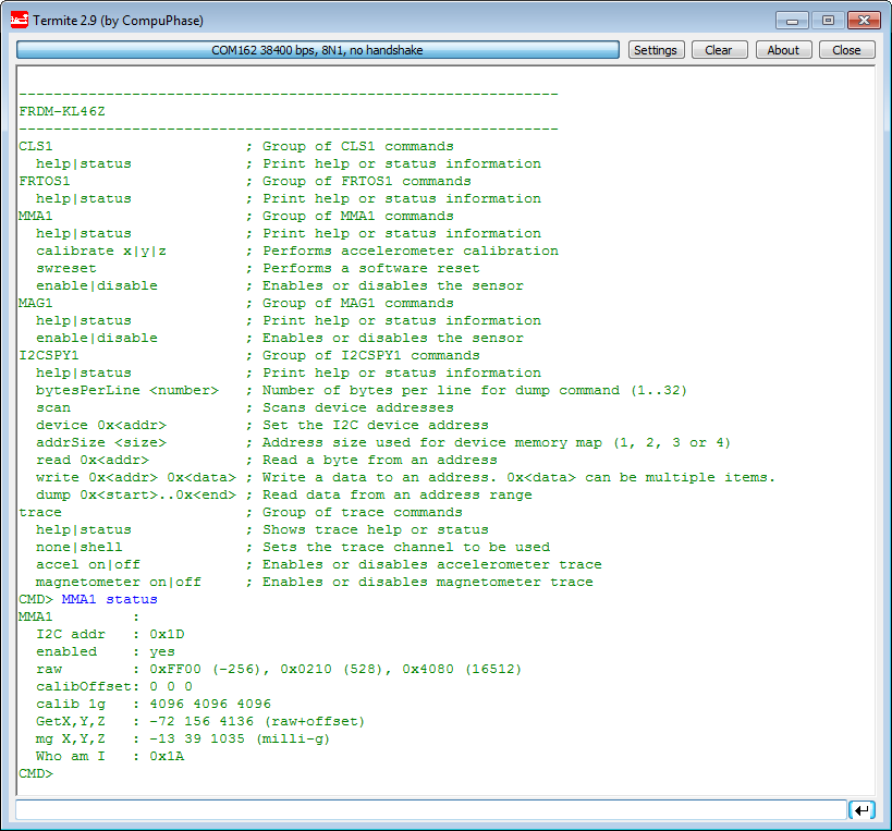

I am trying to create an accelerometer project with the KL43Z or KL46Z. The quick starter pack has sample code project with Keil and IAR but not with KDS. Can anyone please direct me to the location of where I can find a KDS sample code project for accelerometer?
Also where can I find the code for frdm_kl43demo.srec and frdm_kl46demo.srec?

I have an example project here:
mcuoneclipse/Examples/KDS/FRDM-KL46Z/FRDM-KL46Z_Demo at master · ErichStyger/mcuoneclipse · GitHub
You need to install additional components from SourceForge, see http://mcuoneclipse.com/2014/10/21/mcuoneclipse-releases-on-sourceforge/
It features most components on the board, including the accelerometer and magnetometer. It has as well a shell/console interface:
I hope this helps,
Erich
I hope this helps,
Erich
