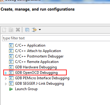

Hello Kenta,
Please check the computer management , if it show the "mbed serial port" like this :
when you debug , please select the "GDB OpenOCD Debugging" :
if PE , select the "GDB PEMicro " , if Jlink , please select "GDB SEGGER J-Link".

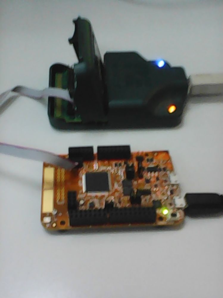

Hi Kenta,
What about your firmware?
The firmware i mentioned is the bootloader for debug , and only need one usb cable .
Please take a picture about  how your board link to PC and the configuration of KDS debugger,
that i can clearly know your meaning.
And please also tell me which debug method do you want to use , or your aim , thank !

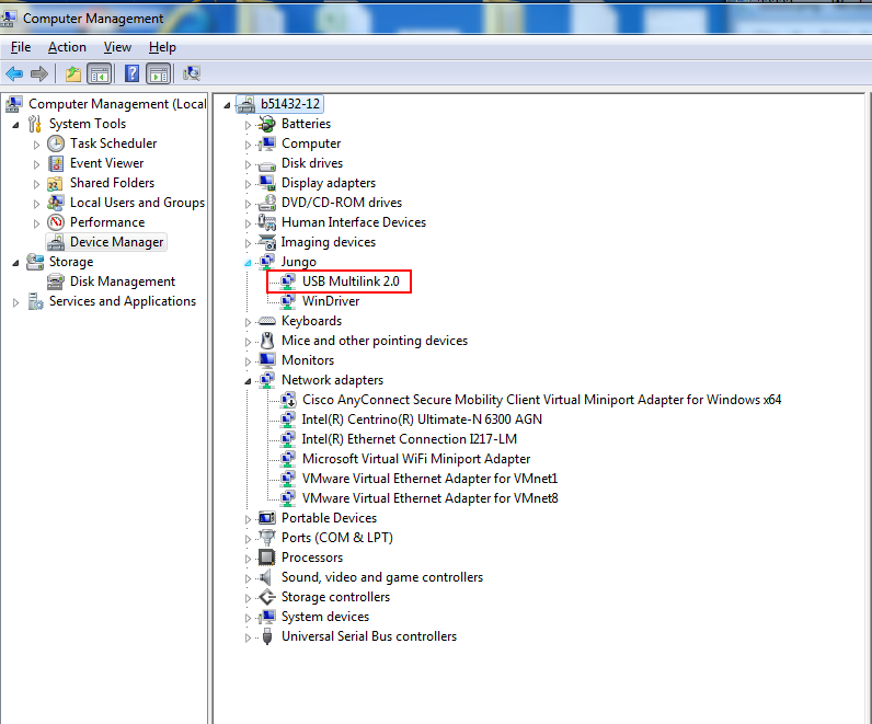

Hello  Kenta,
I have test it use the MULTILINK , it can work well .
- Please first change the bootloader  of the board , for  example , you can change it to jlink
use the "JLink_OpenSDA_V2_1.bin" .
- then connect the board ,debugger to PC :
then check the PC management , whether have the USB Multilink:

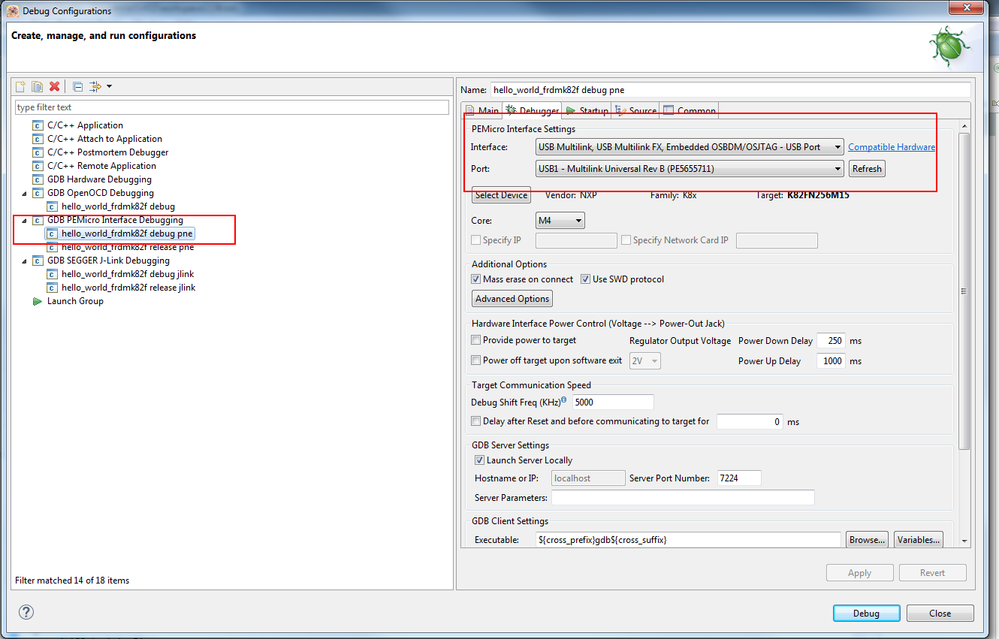

Then configure the debug configuration as this :
Then it can download well :
Hope it helps

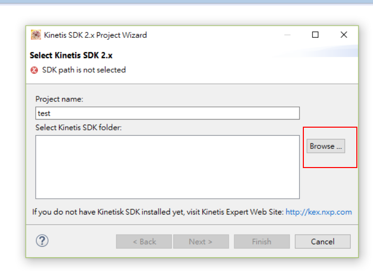

kentachang_melt
Hi Alice,
the KSDK2.0 project is download, But I can’t use it on KDS 3.0.
Kenta
14,153 Views
Hello Kenta,
Pleas select the  SDK folder ,  it is the path of SDK_2.0_FRDM-K82F on you PC.
please refer to the video i mentioned last time : https://community.freescale.com/docs/DOC-329662
in this thread , there is the detail massage about how to use it .
Hope it helps you
Alice

kentachang_melt
Hi Alice,
I hope to program the FRDM-K82F by USB Multilink (SWD port).
The picture is attached.
May I have something wrong.
Kenta
