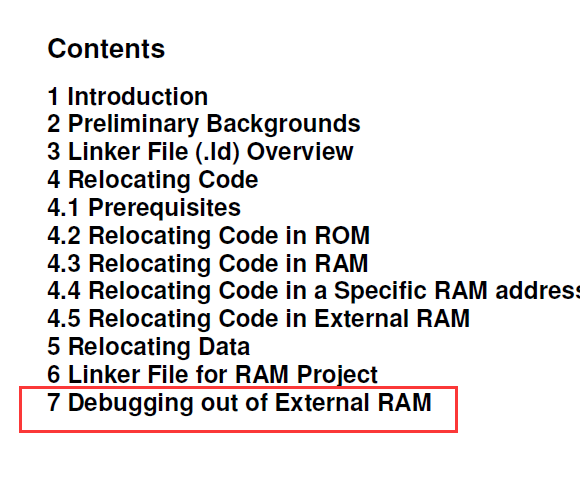

If you want debug on external RAM, you need configure the linker file ,
there is a DOC about how to do in CW, while it is the same with KDS, you can refer to.
Relocating Code and Data Using the CW GCC Linker File for Kinetis

Hello Biafra,
I'm very sorry for my last reply, it seems that we can not download project into SDRAM directly .
for in KDS, I have not find the debugger configure file like "init_kinetis.tcl" .
I will confirm it with KDS expert , then reply you .
Alice

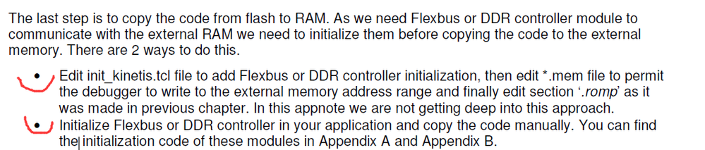

Hi Biafa,
I checked your another question, so suddenly I thought something.
Yes, in KDS, there isn't the two files "init_kinetis.tcl" and "*.mem" (appendix C and D)as that DOC mentioned,
while in the DOC, it said there are two methods :
So maybe you can use the second method replace the two files in the first method.
Alice

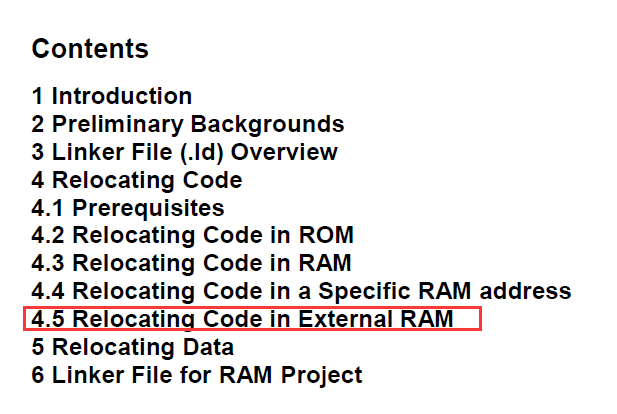

Hello Biafra,
You can relocate your code into SDRAM, about the detail steps
please refer to this DOC:
Relocating Code and Data Using the KDS GCC Linker File for Kinetis
Hope it helps

biafra
Senior Contributor I
Hi Alice,
Many thanks for your answer. I have already read the document you have told me about.
I've not been clear: my problem is not how to relocate the code in SDRAM, this step has already been done. My problem is how I can load the code in SDRAM with the debugger probe in the debugging phase.
Many thanks
Biafra
