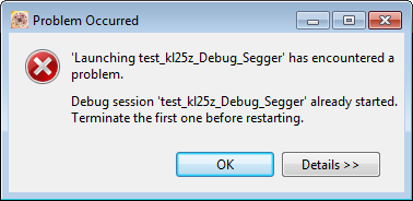

Not Debugging Twice: Make sure that you are *not* debugging the same application board twice, or you will get this:
Because the board is already running a debug session:
Always terminate an existing debug session before starting a new one:

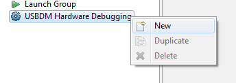

  5. Select the USBDM Hardware Debugging group and select new from the right-click menu or the new icon at the top of the dialogue.

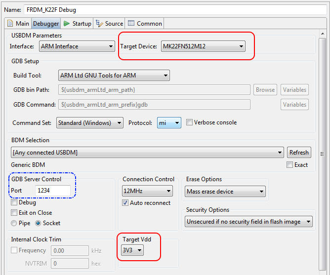

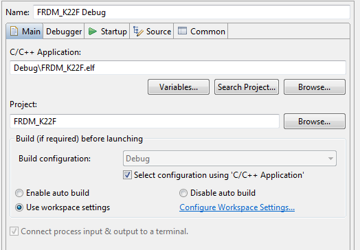

  7. The dialogue that open is similar to a standard Eclipse Launch configuration.  The first page should be correctly fill out providing an existing correctly built project was selected earlier.  You can use the browse button to select other build targets if desired.  IN the example shown the Debug build was currently selected in the build target (project selected).
  9. The second tab will usually need modification  The most important items are the Target Device selection and the target Vdd (only needed for targets with switchable target power such as K22F). You can also the  change the socket used by GDB if desired. This may be needed if you want to debug multiple targets using two instances of KDS.

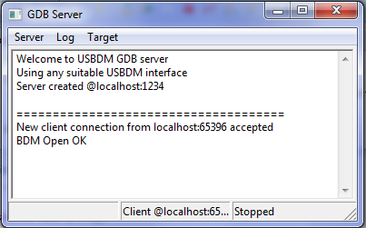

  12. The USBDM GDB Server will be started as a separate process with its own GUI window:

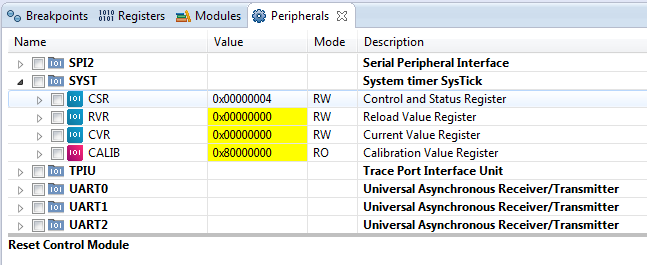

  14. After launching the target registers may be examined in the Peripheral view.

Why is it always necessary to terminate the last debugging session before starting a new one. This is not the way it was in Code Warrior. Is there anyway to workaround this or fix this?
Hi David,
It is a problem how Eclipse GDB launches the debug session, or how the started session checks if it is already running. This needs to be done at the plugin level. CodeWarrior has it implemented as it is using its own debug engine.
Normal GDB launcher plugins do not check this.
I'm only aware that the GNU ARM Eclipse one (which is in KDS v3.0.0) can check if there is already a debug session running, and offers this dialog:
But it is for Segger J-Link only (P&E and OpenOCD have not implemented that (yet?)).
So the workaround is to use J-Link in that case. For P&E or OpenOCD you have to terminate the debug session first.
