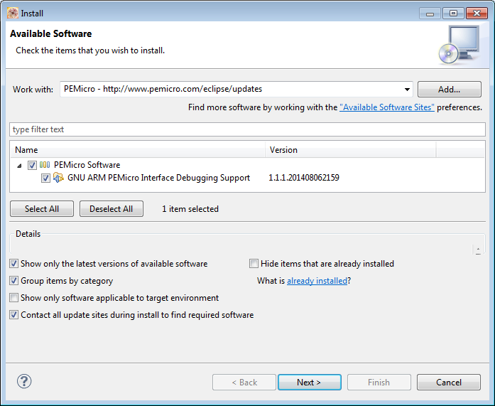

Update KDS from P&E Update Web Site
For KDS V1.1.0, you need to install an update throught an Eclipse update. The update is from www.pemicro.com/eclipse/updates within the Install New Updates dialog under the Eclipse Help menu.

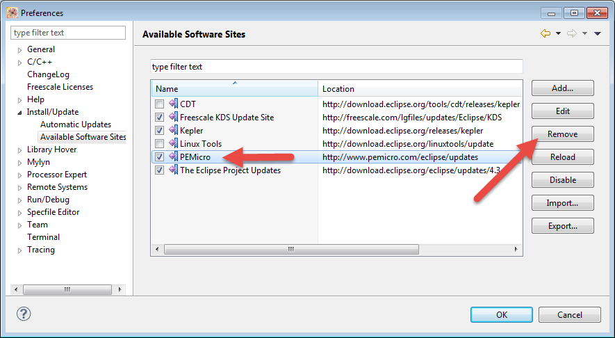

a. Remove the PEMicro -
http://www.pemicro.com/eclipse/updates update site from the list of available update sites. Use the menu Help > Perferences > Install/Updates > Available Software Sites and Remove the PEMicro entry:

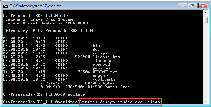

b. Exit the KDS Eclipse IDE and restart it from the command line with the  -clean parameter. On Windows start Eclipes from the cmd.exe (DOS shell) with the -clean parameter:

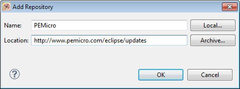

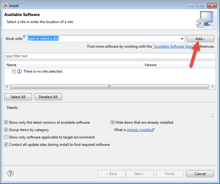

c. In Eclipse, add the PEMicro -
http://www.pemicro.com/eclipse/updates update site. Use the menu Help > Install New Software and press the Add button:
d) Enter http://www.pemicro.com/eclipse/updates as update Location and press OK:
e) Then update from P&E's website:

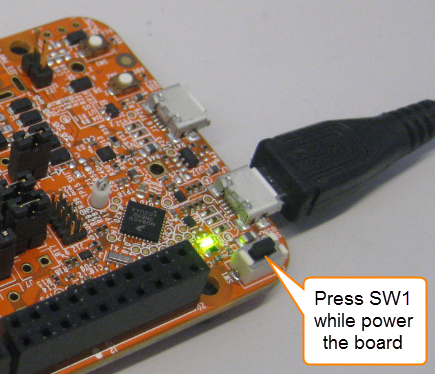

Installation of P&E OpenSDA V2.1 Firmware
You need to install the P&E OpenSDAv2.1 firmware on the board, and you only need to do this once (unless you change the firmware again).
  1. Go to http://www.pemicro.com/opensda/ and download the OpenSDA Firmware Apps file (zip file) (requires registration at P&E)
  2. Unzip the firmware files to a folder on your harddisk.

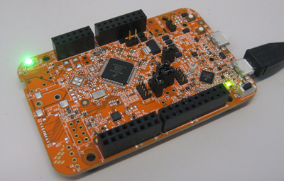

  3. Power the board/Plug in the USB cable with the OpenSDA USB port, while having the Reset/SW1 pressed.
  4. The device should enumerate BOOTLOADER: device on your host. You are now in bootloader mode.
  5. Copy the the correct firmware file (DEBUG-FRDM-K22F_Pemicro_v108b_for_OpenSDA_v2.1.bin) to the BOOTLOADER device. Wait a few seconds to complete the operation.
  6. Unplug the board, and now power it normally (without SW1 pressed)
  7. The board should now show up as OpenSDA device, a virtual COM port and as PEMicro OpenSDA Debug Driver:
    13840_13840.pngpastedImage_5.png13841_13841.pngpastedImage_7.png13842_13842.pngpastedImage_8.png
  8. You are ready to use to debug the FRDM-K22F as if you would use a P&E Multilink :-)

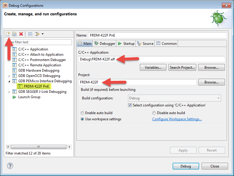

Create a new debug/launch configuration: Select your project, then use the menu Run > Debug Configurations.
Use the 'new' Icon to create a new configuration for your application and project (Main tab):

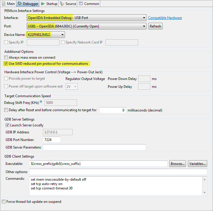

In the Debugger tab, specify OpenSDA Embedded Debug as Interface, select the OpenSDA device as Port, and select the K22FN512M12 as device, and make sure 'SWD' is selected:

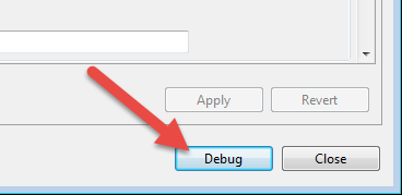

That's it. Now you can debug your application with P&E OpenSDA V2.1 firmware on the board :-).
You can use the 'Debug' button in the launch configuration:

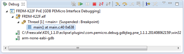

And then I'm debugging the FRDM-K22 with the P&E OpenSDAv2.1:
Happy Debugging :-)
