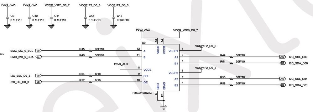

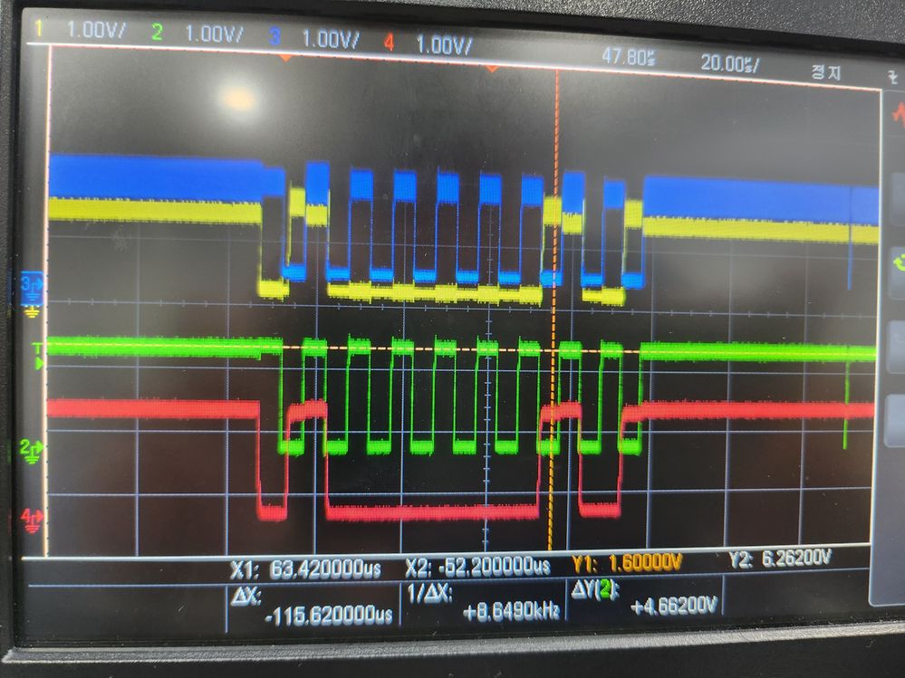

Hi.
I don't know why output voltage drop(VCCP1 & VCCP2 Output voltage : 1.65V).
Using voltage is below.
VCCR : 3.58V
VCCS : 3.3V
VCCE : 3.3V
VCCP1, VCCP2 : 3.3V
1-host : 2-device
host is stm32(Only normal I2C, not I3C)
device is normal eeproms
Thank you.

Could you please help and share with your schematic?

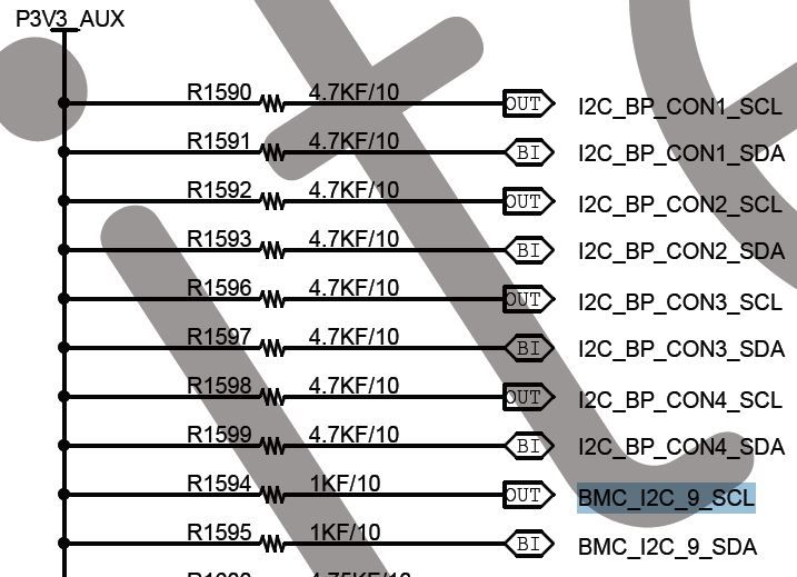

1-host(stm32) has above pull-up value.

For the IIC use case you should add the pull up resistors.

1-host have Pull-up.

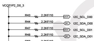

On both sides need pull up resistors.
Did you add on both sides?
5,289件の閲覧回数
JaeHwan
Hi, guoweisun!
Yes. add on both sides!
above schematics.

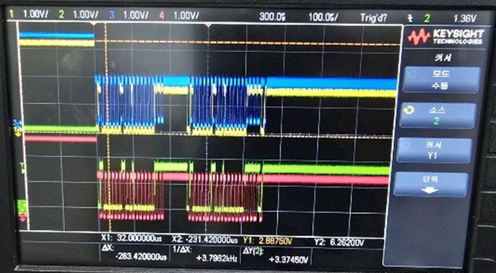

guoweisun

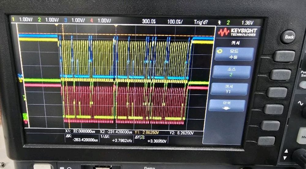

 For the output voltage drop waveform,can you give clear picture again for better analysis?
5,164件の閲覧回数
JaeHwan
Hi.
Thank you.
5,160件の閲覧回数
guoweisun

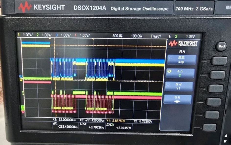

Can you zoom in your waveform? I need to see the  drop value.
5,154件の閲覧回数
JaeHwan
5,145件の閲覧回数
guoweisun
The input signal is not up to 3.3V.,can you test the input signal disconnect with this P3S0210BQ to confirm whether it's 3.3V signal?

JaeHwan
Hi. guoweisun!
I solved.
Add 47pF capacitor at Input and output lines.
Thank you.
