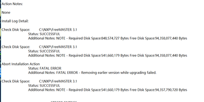

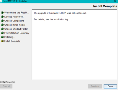

My Win10 can not install FreeMaster3.1.2

 Why?Can you help me? Thanks!

According to your installation log the installer was unable to clear previous version of FreeMASTER 3.1. It's hard to say what exactly caused the failure. Here are a few options to try:
  • Could you uninstall previous FreeMASTER 3.1 from "Program and Features" or by running "FreeMASTER 3.1\_FreeMASTER_installation\Uninstall FreeMASTER.exe"
  • In case there's no such entry in "Program and Features" or the uninstaller is missing - remove "FreeMASTER 3.1" folder and all its content manually.
    Try launching the installer.
  • If it complains about a previous installation you may need to remove FreeMASTER 3.1 registry entry from "C:\Program Files (x86)\Zero G Registry\.com.zerog.registry.xml" - a quick solution is to rename original file to ".com.zerog.registry_backup.xm" in case there other entries beside FreeMASTER.
Hope this helps.

ArchieLuo
Thanks!
"remove "FreeMASTER 3.1" folder and all its content manually".
