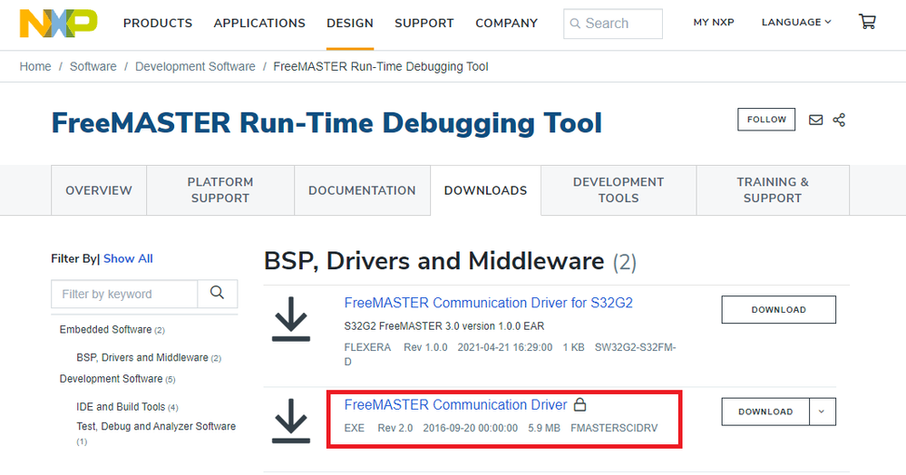

Hi @Gayan_Niroshana,
You can start by downloading FreeMASTER Communication Driver package available on FreeMASTER page  under Downloads tab.
This package include FreeMASTER Driver source code, documentation and example applications. By default it will extract all the content into C:\NXP\FreeMASTER_Serial_Communication_Driver_V2.0.
You can refer to the user guide located in doc\UserGuide for driver configuration. MPC57xx example applications can be found in examples\SCI_driver_examples\MPC57xx.
Additionally, there are a few articles explaining how to add FreeMASTER dependencies and configure the driver.

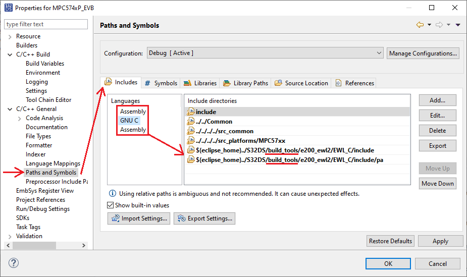

I found this example here; C:\NXP\FreeMASTER_Serial_Communication_Driver_V2.0\examples\SCI_driver_examples\MPC57xx\MPC574xP_EVB for my board.
I'm currently using S32 DS v2.1. This example can't be compiled and it shows following errors.
Is this a version mismatch of S32 DS or any other reason?

iulian_stan
I think the example project was indeed made with an older version with DS, but I was able to build it with S32 DS for PA 2.1 by updating the path to EWL library. The old version expects it to be in S32DS_Power_v2.1\S32DS\e200_ewl2, but it seems to be moved to S32DS_Power_v2.1\S32DS\build_tools\e200_ewl2.
Here are my changes:
1. Update Sysroot in Target Processor Settings:
2. Update Include Path and Symbols:
One thing to note - as far as I know there were multiple revisions of the board - make sure PIN routing used in the project (periphinit.c) matches your board.
