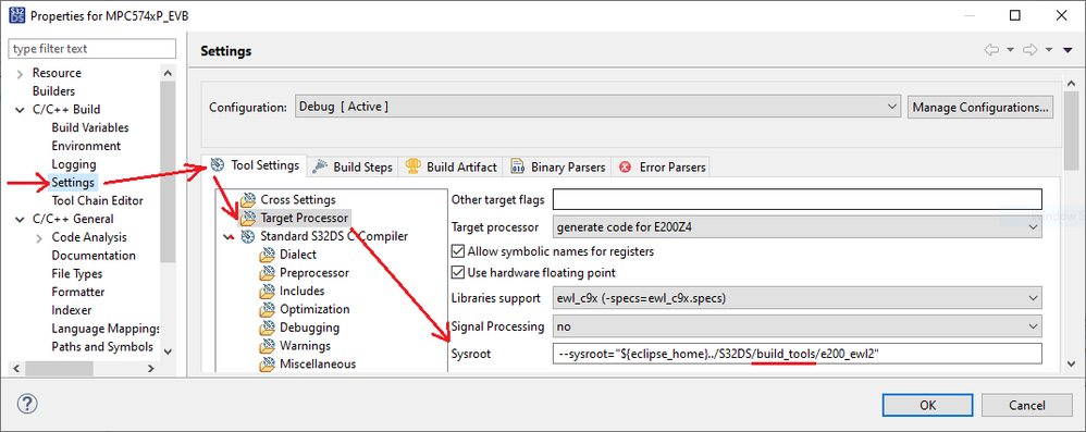

I found this example here; C:\NXP\FreeMASTER_Serial_Communication_Driver_V2.0\examples\SCI_driver_examples\MPC57xx\MPC574xP_EVB for my board.
I'm currently using S32 DS v2.1. This example can't be compiled and it shows following errors.
Is this a version mismatch of S32 DS or any other reason?
Thanks & Regards,
Gayan.
17,277件の閲覧回数
iulian_stan
Hi @Gayan_Niroshana,
I think the example project was indeed made with an older version with DS, but I was able to build it with S32 DS for PA 2.1 by updating the path to EWL library. The old version expects it to be in S32DS_Power_v2.1\S32DS\e200_ewl2, but it seems to be moved to S32DS_Power_v2.1\S32DS\build_tools\e200_ewl2.
Here are my changes:
1. Update Sysroot in Target Processor Settings:
2. Update Include Path and Symbols:
One thing to note - as far as I know there were multiple revisions of the board - make sure PIN routing used in the project (periphinit.c) matches your board.

Gayan_Niroshana
Hello @iulian_stan ,
I think the example project was indeed made with an older version with DS, but I was able to build it with S32 DS for PA 2.1 by updating the path to EWL library. The old version expects it to be inS32DS_Power_v2.1\S32DS\e200_ewl2,but it seems to be moved to S32DS_Power_v2.1\S32DS\build_tools\e200_ewl2.
Thanks you very much. These changes works fine. The program runs on the board now (Using S32DS v2.1) and the variables can be monitored using freemaster properly.
For the other case I'll make changes as per to your suggestions and give an update on that.
