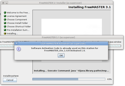

I apologize for spamming you with something that may not be useful to others, because only NXP can help me with this problem, but NXP tech support suggested I post my question here.
Symptom
I Couldn'n install FreeMaster 3.1. for Linux, because the Software Activation Code NXP sent to me is for another version: FreeMaster Lite 1.0.R. I couln't find such at the download section.

  • Downloaded FreeMaster 3.1 (latest)
  • Received Activation Code for FreeMaster
  • Started installing FreeMaster
  • Entered Activation Code
  • Got error message
  • Entered Activation Code again
  • Got error message (see screenshot)
  • Submitted a ticket
  • Added screenshot
  • Wait for answer

Oh, thanks, FreeMaster Lite is installed now. When I start it, it prints some messages, I think the most important one is: listening on port 8090. Is it okay?
FreeMaster Lite is runningFreeMaster Lite is running

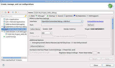

How can I upload my ELF to the S32K148EVB-Q176 board? The device does not appear on the list:
port_nope.pngport_nope.pngAnyway, the target is not the exact type. I'm running the application as root (not too elegant, but it does not even starts with regular user), the /dev/ttyACM0 is present, the VM (Oracle VirtualBox 6.3) is set to enable USB3.0 on the USB port, the ELF is created, I just want to upload it to the board.

Hi @ern0,
Here is the link to the latest license for FreeMASTER Lite. It should redirect you to FreeMASTER product license page and generate a new mail in case it is the first time you access this link.
FreeMASTER installer should prompt a message to visit this link/web page after component selection step:
In case the mail is not generated, you can find it on the licensed products page assigned to on your account on NXP site:
Kind regards,
Iulian

I just don't know, how can I upload my ELF:
  • the SDK can't recognize the port,
  • FreeMaster looks like a CLI daemon.
See screenshots from my previous comment.
Anyway, this is another topic, not FreeMaster-install related.

But then, what's the easiest way to upload ELF to the board? I don't want to play with FreeMaster API or anything, I just want press the big green button to run the helloworld example program on the board.
As I mentioned, the SDK installation was a challenge, and once it installed, it was not working - which was a new experience for me, never seen such before.
Probably, as we say, I'm "not the sharpest knife in the drawer", but a helloworld should not be a 3-day challenge even for a beginner.
6,006件の閲覧回数
iulian_stan
The right tool, both for developing an application and loading, debugging it on NXP hardware is S32 Design Studio.
Unfortunately, the best I could do in this case is pass your message to the IDE team because FreeMASTER is unrelated to S32DS. And I guess there is a misunderstanding - FreeMASTER does not offer the functionality of flashing/loading applications to MCUs.
I would suggest reaching out directly to S32DS team via S32DS community and open a separate thread describing your issue (S32SD not being able to detect the MCU on Linux).
