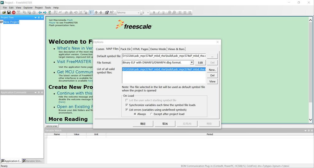

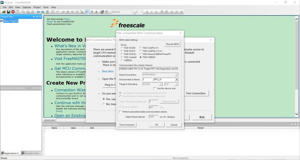

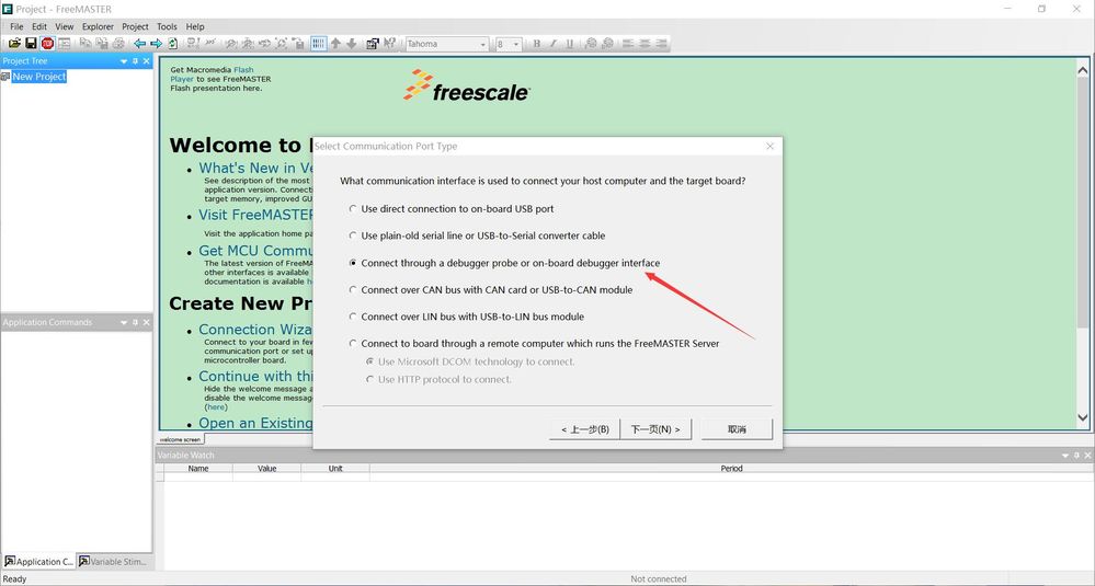

     I am tyring to connect the development board to the FREE MASTER v2.0 through OSJTAG.The connection mode I chose is as follows:
step one:
step two:
step three:
step four:
step five:
step six:
step seven:
       Although the software shows that I am connected, the data cannot be updated. So I'd like to ask, what's wrong with my operation steps? Is the connection mode selected wrong? Can someone show me the correct operation? Thank you.

can you try to use the option P&E Nexus/OSBDM PowerPC?
I also recommend to upgrade to the latest FreeMASTER 3.1.3 as available on the nxp.com/freemaster. This version has more recent version of P&E drivers and it may work better in this case.

Thank you very much for your reply!! I've solved the problem. The problem was due to the wrong connection.Your suggestion is very effective.
