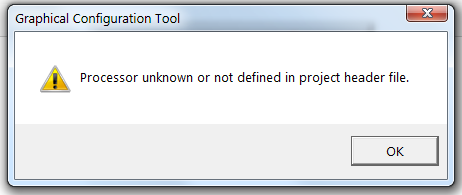

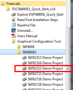

On DSC56800EX_Quick_Start_r2.6 start up from the windows menu:
But I have this Error.
How to solve it ?

Hello Antonio,
I can reproduce the issue.
The gct56F800.zip file contains update of the QuickStart GCT, which fixes the issue
Thegct_cfg_pinout.zip file contains update of peripherals and the pinout page for all derivates.
To apply the update unpack the files to <DSC56800EX_Quick_Start_r2.6_path>\tools\gct\
Jaroslav
