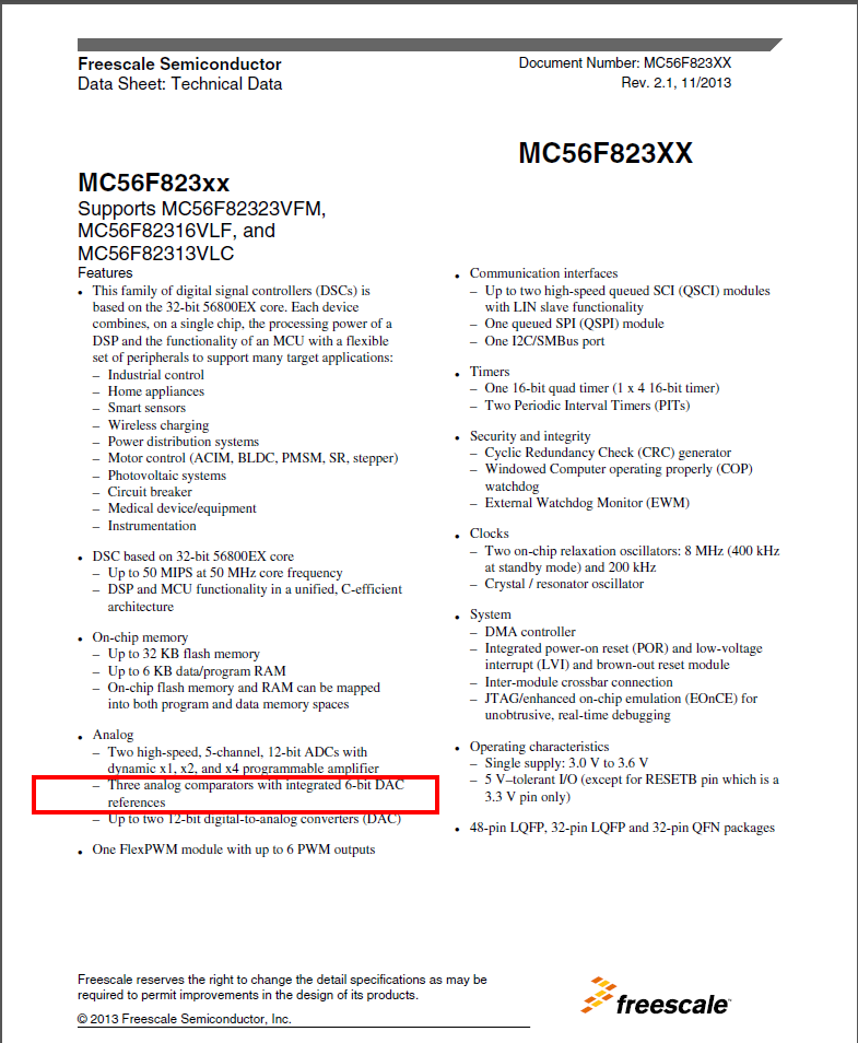

the MC56F82323 has two or three Comparators on ADC inputs ?
2,896 Views
antonio66
Because,
on MC56F823XX.pdf and on MC56F823XXRM.pdf is writed:

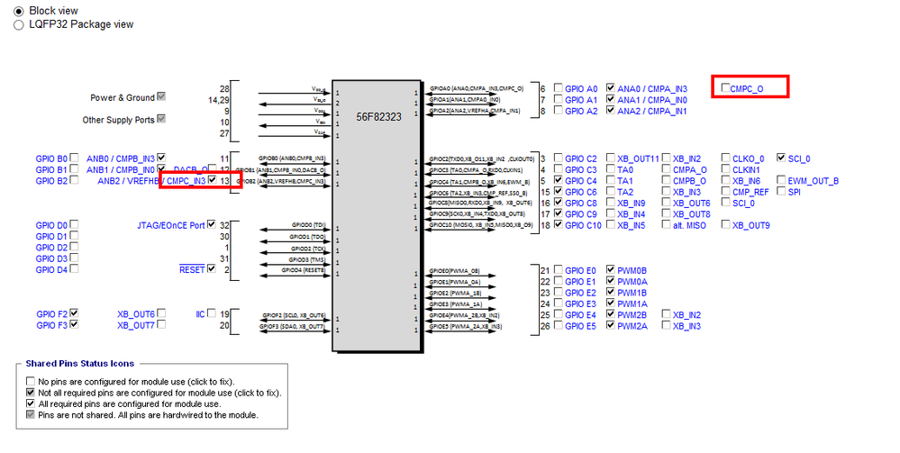

But on Processor Expert and in DSC56800EX_Quick_Start there are 3 comp !

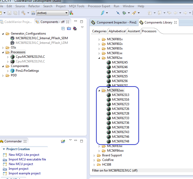

The information on our documents (Data Sheet and Reference Manual) is correct.
What is the CodeWarrior version you are using? MC56F82323 is not supported by Processor Expert in CodeWarrior v10.6.2. And I checked in CW10.6.3, it is not supported either. Could you please send me a screenshot to show the Processor List in Components Library like below?
Thank you very much!

Sorry youa are right: in the processor expert i used the MC56F82723.

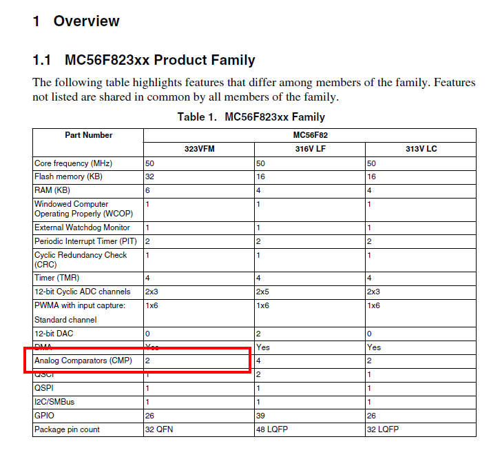

but on manual
But in the Quick_Start:

Thanks Antonio, we will look into this and confirm.
