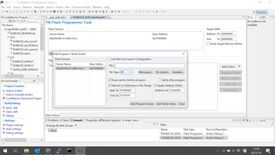

I'm using Codewarrior studio for Power Architecture
I'm just wanting to write elf program on Nor Flash device s29gl01gt11tfiv10
without address re-translation of elf format
just wanting to write an elf file image on flash memory
I tried options that Flash programmer task offers
But
-t "Auto Detect"
doesn't disappear in console log
isn't there any way to disable "Auto detect" option when writing elf file?
1,672 Views
yipingwang
When you add “Program/Verify" Action, please specify the File Type as "Elf".
