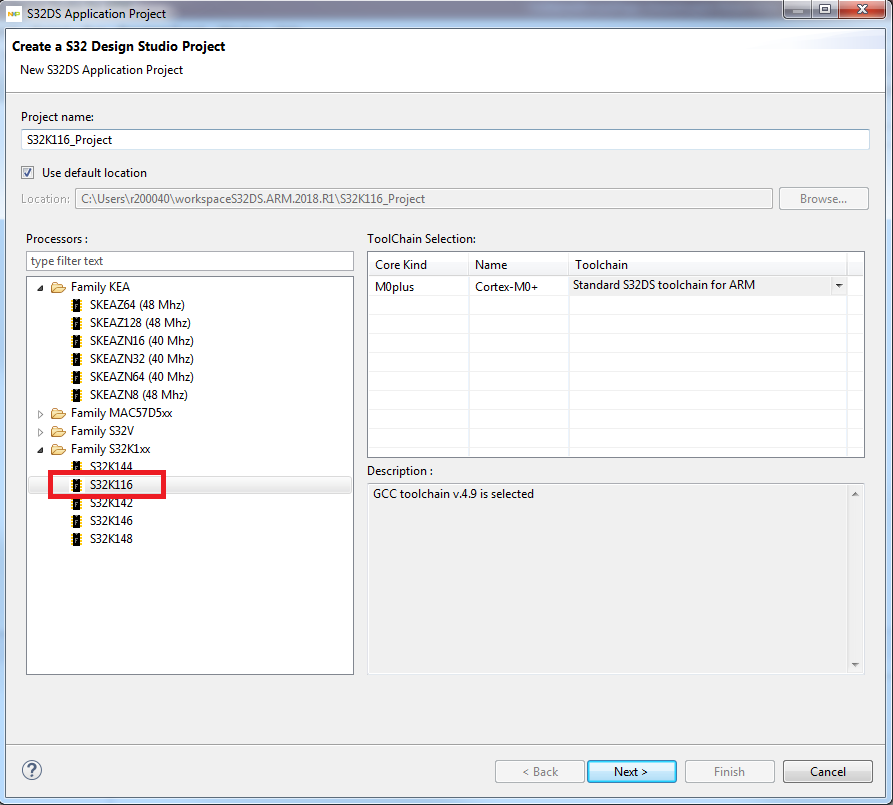

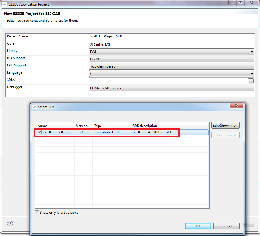

  • This update adds device support for S32K116  and installs the S32 SDK 1.8.7 EAR (Early Access Release) supporting the S32K116 (see attached S32K116 SDK release notes for more details)
  • S32K116 EAR SDK v1.8.7 Examples - "Create S32DS Project from Example"

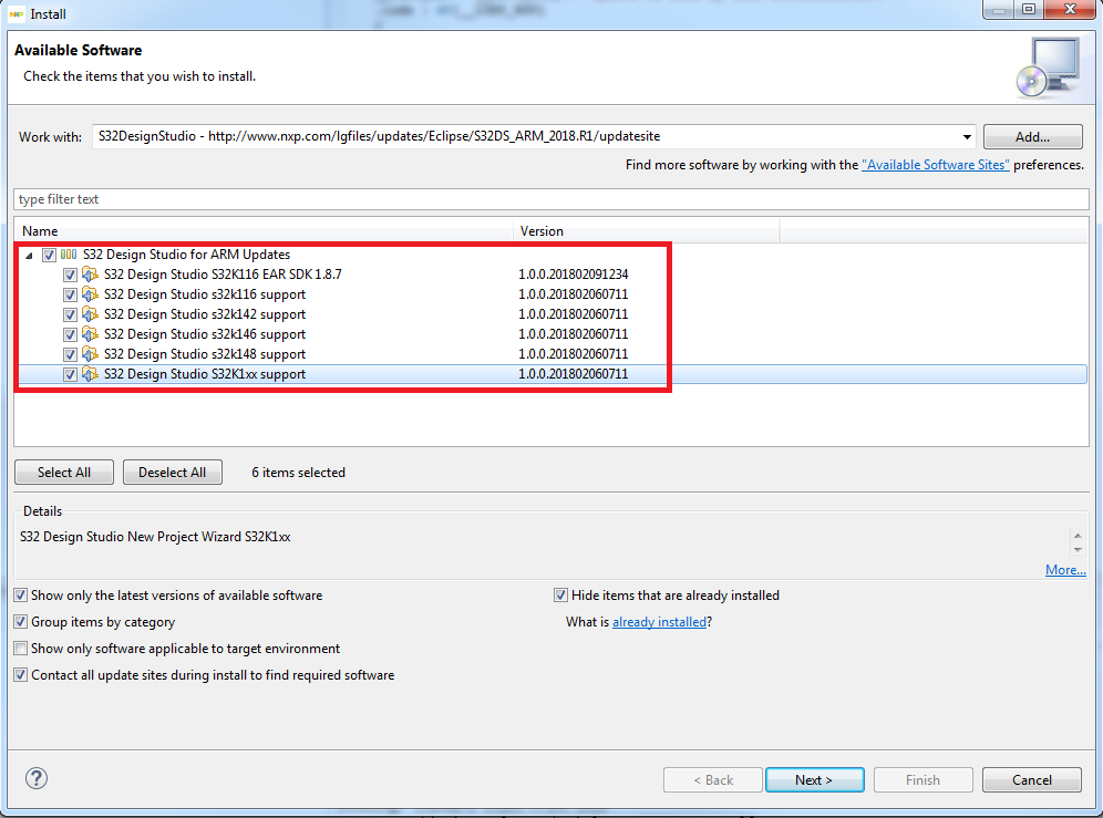

The update is available for online (via Eclipse Updater) or offline installation (direct download link)
  • offline installation:
    • go to S32 Design Studio for ARM product page -> Downloads section or use direct link to download the update archive zip filepastedImage_1.png
    • Start S32DS and go to "Help" -> "Install New Software..."
    • Add a new "Archive" repository and browse to select the downloaded update archive zip file you downloaded in the previous step
    • Select all available items and click "Next" button.
This will starts the update installation process.
