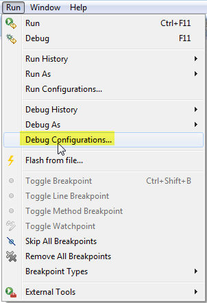

In order to have most fields of the debug configuration pre-populated, select the project in the Project Explorer view:
Select the menu Run > Debug Configuration:

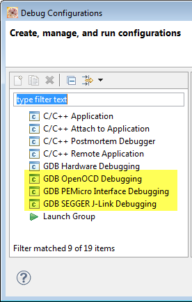

Kinetis Design Studio supports three different debugging connections:
  1. GDB OpenOCD Debugging: this uses the OpenOCD to CMSIS-DAP debug protocol, available with OpenSDAv2.0 (FRDM-K64F) or OpenSDAv2.1 (FRDM-K22F)
  2. GDB PEMicro Interface Debugging: this can be used for any P&E device (Multilink, or OSJAT/OpenSDA P&E firmware on a Freescale board)
  3. GDB SEGGER J-Link Debugging: this can be used with any Segger device (J-Link, or OpenSDA J-Link firmware on a Freescale board)

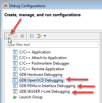

Double click on one of the entries to create a new configuration for it. Instead double clicking you can use the 'New' icon as well:

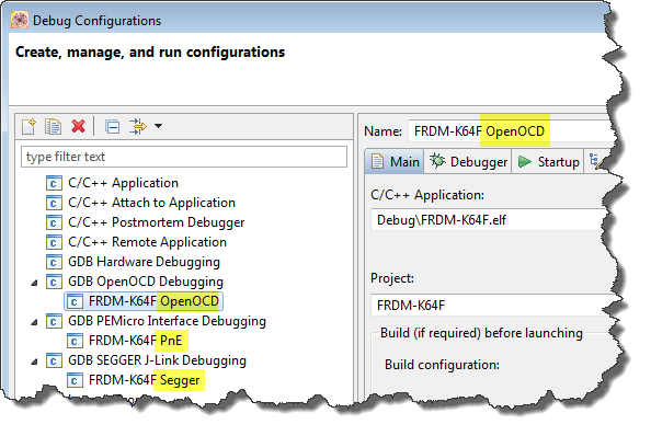

What I recommend is to name the debug configuration. So I know later which configuration is for what. What I'm using is <project name><connection> like below:

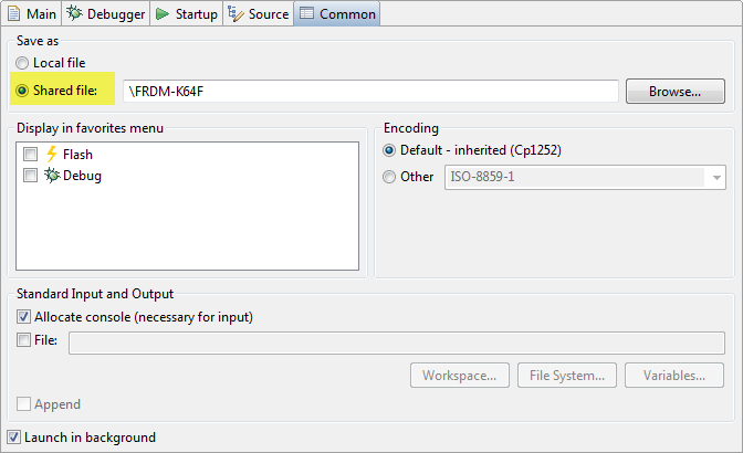

Another thing I highly recommend is to save the debug configuration as file in the project (.launch). This allows sharing or passing the debug configuration with the project files.
To do this, I have 'Shared file' enabled:
That way the launch configuration files are stored in the project:

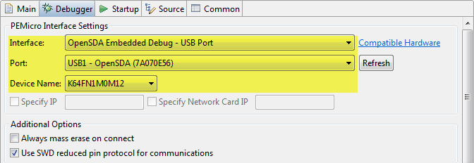

For P&E: select the interface, port and device:

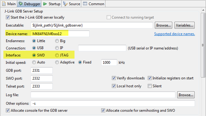

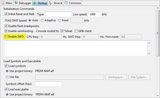

For Segger, specify device name, interface (use JTAG only if you know the debug header supports JTAG. If in doubt, choose SWD):
SWO (Single Wire Output) is an extra pin to SWD/JTAG, and currently not supported on FRDM boards. So I disable that option for my FRDM boards, as otherwise the debugger will complain later about it:

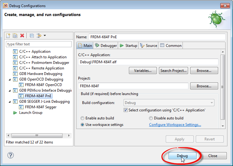

To Debug, one way is to use the 'Debug' button from the Debug Configuration dialog:
You have to do this at least once.

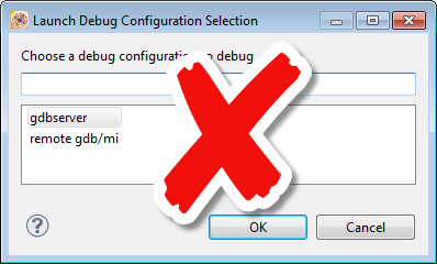

And if you get the dialog below:
DO NOT select either gdbserver or remote gdb/mi: it does not work that way :-(
Press Cancel, and select it from the list, or select it from the 'Debug Configurations...' dialog:

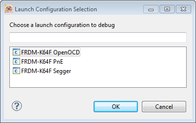

Although KDS V1.1.0 has improved in this area, it is possible that it will show you a selection of launch/debug configurations (then you are ok to choose one):
The recommended way is to use the drop down list and to select the desired debug/launch configuration:

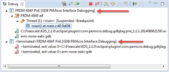

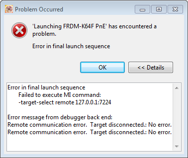

Not Debugging Twice: Make sure that you are *not* debugging the same application board twice, or you will get this:
Because the board is already running a debug session:

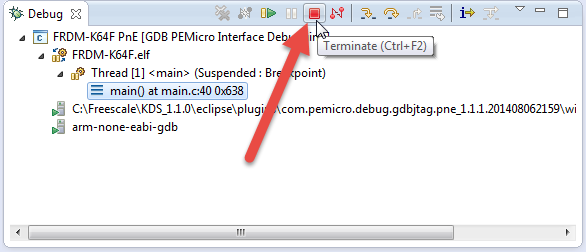

Always terminate an existing debug session before starting a new one:

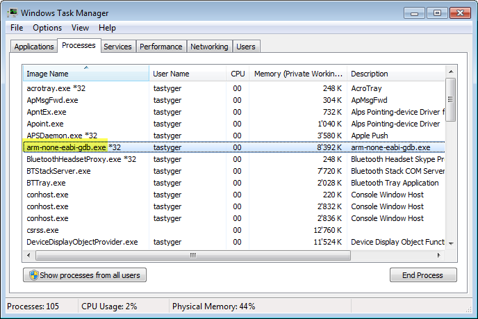

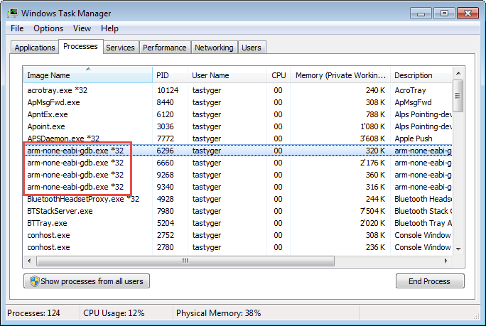

Kill any Zombies: the gdb client and server are usually terminated after a debug session. After terminating a debug session, verify that these services are *not* present any more in your task manager (Windows):
  1. arm-none-eabi-gdb.exe: this is the ARM GDB client, needed for the OpenOCD, Segger and P&E servers listed below
  2. openocd.exe: this is the OpenOCD GDB server
  3. pegdbserver_console.exe: this is the P&E GDB Server
  4. JLinkGDBServerCL.exe: this is the Segger GDB Server
If you see multiple zombies/instances like this: kill them:
