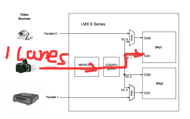

Hi, all:
     Now, I have some trouble.
     <1> mipi-csi2 status is that, err1 = 0, err2 = 0, dphy_stat = 0x300 <-> 0x310. I think this is a correctly status.
     <2> I not to set csi2ipu register and mux register.
     <3> No interrupt to call function camera_call. It maybe the data flow is block. But i have no idea to debug it.
     <4> Framework is:
     <5> Follow is debug information.

Hi guanliang
for csi2ipu muxing and setting correct mipi frequency
please look at document on below link
Debug steps for customer MIPI sensor.docx 24.9 K
Some Experience When Enable MIPI Camera
igor

Hi, igor:
     Thanks.
     <1> I think mipi-csi2 controller working correctly, and csi2ipu gasket not to setting, it will not block the data flow. At most , data format error.
     <2> You provide the document, I have a reference. But still no idea.
     <3> The error of "enc->counter = 0", can you give me some method to solve.

For the MIPI virtual channel !=0 setting, you need reference to this sample code Sample code for iMX6 SabreSD to use MIPI CSI camera with virtual channel 3
And for MIPI interface TVin chip, in your driver, ioctl_g_ifparm(), it should be as followed:
static int ioctl_g_ifparm(struct v4l2_int_device *s, struct v4l2_ifparm *p)
/* Initialize structure to 0s then set any non-0 values. */
memset(p, 0, sizeof(*p));
p->if_type = V4L2_IF_TYPE_BT656; /* This is the only possibility. */
p->u.bt656.mode = V4L2_IF_TYPE_BT656_MODE_NOBT_8BIT;
p->u.bt656.clock_curr=1;
p->u.bt656.bt_sync_correct = 1;
static int adv7282m_probe(struct i2c_client *client,
    const struct i2c_device_id *id)
adv7282m_data.sen.pix.priv = 0;
5,455 Views

     According the register value, we know data flow is CSI0->IC->IDMAC->BMEM. Because channel 20 be selected. But channel 20 can't trigger interrupt to get data. In a other word, it can't call function camera_callback to handle data. Have you ever meeting? Could you give me a debug direction? Thanks.

The CSI_xxx registers are totally wrong from your dumpped information, I think you'd better use the mxc_v4l2_tvin.c test application to test the function of CSI->MEM capture first.

Hi, Qiang Li:
     In the normally capture mode, what is the right data flow in the IPU. What is the correctly dump information. And where can i download mxc_v4l2_tvin.c.

You can use my mxc_v4l2_tvin_isl79985.tar.gz. IPU capture the CSI video data to memory buffer directly, then draw it to frame buffer for preview.

Hi, Qiang Li:
     In ours debug process, we always meeting so much register haven't detail information in the RM. How can i to solve this problem.

guanliangding
Hi, Qiang Li:
     In ours chip, output format is yuv422. so we don't need to care bt656 related setting.  And I dump part of IPU register. in follow:
