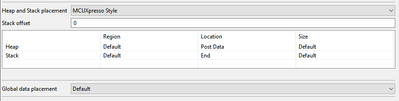

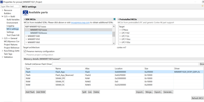

A new project based on the SDK configures the the RAM in this way:
And the linker:
Where "Default" means SRAM_DTC. With this setup my stack, heap, .bss and my .data sections will be placed in the DTC_RAM partition.
In addition the default size of each partition, set by fuses, is
- DTCM 64Kb
- ITCM 64Kb
- OCRAM 128Kb

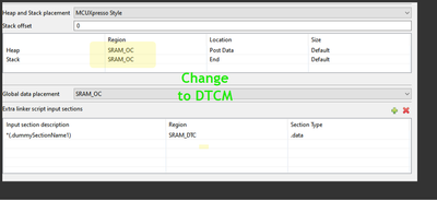

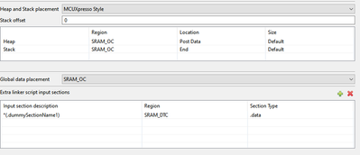

So, first of all I changeg the default settings in the linker setting as follow
It works, now my .stack, .heap, .bss and .data are located in the OCRAM.
My problem starts when i try to locate my data in DTCRAM. I'm using the definitions in cr_section_macros.h to place element in SRAM_DTC (RAM). Despite all the attempts, looking at the Image Info, my example vector (vet[]) still remains in the OCRAM. These some of my attempts:
__BSS(RAM) uint8_t vet[255];
__BSS(SRAM_DTC) uint8_t vet[255];
__DATA(RAM) uint8_t vet[255];
__DATA(RAM_DTC) uint8_t vet[255];
__SECTION(data,RAM) uint8_t vet[255];
__SECTION(dummySectionName1,RAM) uint8_t vet[255];
The last refers to "dummySectionName1" that has been declared as .data type section in the linker settings as follow:

   When you want to put all the heap and stack in the DTCM, you need to make sure your DTCM is enough to use, as you said, RT1020 default flexRAM situation is:
 OCRAM:128k, ITCM/DTCM:64k.
  Then, to the memory put, it is easy, change the heap and stack to DTCM:

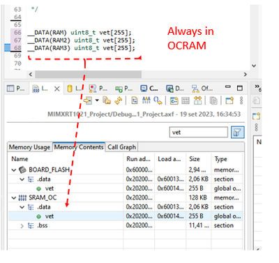

1 - First Topic: how to reallocate data in DTCM, ITCM ot OCRAM.

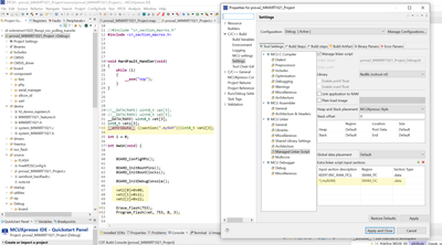

I read the thread Relocating Code and Data Using the MCUXpresso IDE , I imported the three examples in my workspace and this demonstrate that I still have a problem. The reallocation of code in RAM and code in FLASH work properly, whatever RAM or Flash alias I use.
On the contrary, the reallocation of data in RAM doesn't work.
If I set the OCRAM to be used for heap, stack and global placement (c/c++ Build > Settings > MCU Linker > Managed Linker Script) the example vector vet[] will be always put in the OCRAM, despite the alias I indicate in the __DATA() directive.
If I set the DTCRAM to be used for heap, stack and global placement (c/c++ Build > Settings > MCU Linker > Managed Linker Script) the example vector vet[] will be always put in the DTCRAM, despite the alias I indicate in the __DATA() directive.
I tried to use the __BSS() reallocation, just to be sure, the behavior is the same, the reallocation doesn't work.

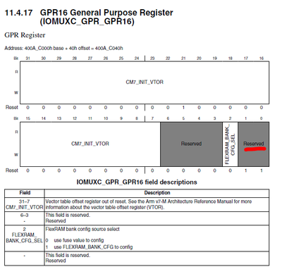

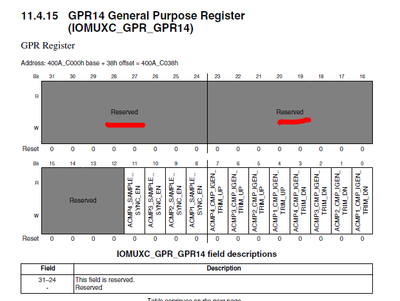

I follwed the Reallocating the FlexRAM procedure after reading the AN12077. My target is to allocate all the RAM space (256KB) to the OCRAM. I'm stucked on these points:
  • The procedure uses assembler to set the IOMUXC_GPR_GPR16 and IOMUX_GPR_GPR17 registers. Why should not I use the easiest assigment for reference like this?
  • I don't have the bits to disable SRAM_DTC and SRAM_ITC in the IOMUXC_GPR_GPR16, does this means I can't set to 0KB ITC and DTC or easily is not necessary to move these bits for XRT1021 device?
  • The code attached to the procedure, but the procedure too, refers to setting the IOMUX_GPR_GPR14 (the 16 MSb) register. I think this register is different in my 1021, since these bits are indicated as reseved. So, does this means is not mandatory for my device or do I have something different to do?

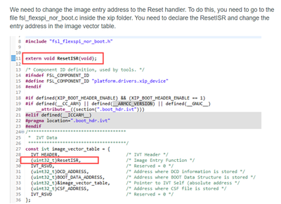

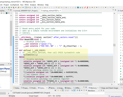

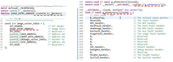

  • The last step changes the image entry address to the ResetISR() address:
    My project is set as follow:
    Why should I replace the reset vector address with the ResetISR() function address?

2. About the post and RM difference, if the RM don't have the related bit anymore, you don't need to control that register, as that is not needed, I have checked it internally previously, thanks.
About Why should I replace the reset vector address with the ResetISR() function address?
I also have the question, why you replace the vector address? You don't need it, just need to add the flexRAM remap register control in the reset handler code.

  1. I found the origin of the reallocation issue. But I dont't know how to solve it. Please refer to the attached project.

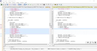

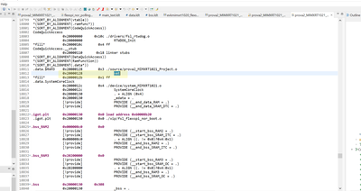

    The reallocation failure comes when I copy the folder "linkrscripts" inside my project. I took this folder from the example project "evkmimxrt1020_flash_component_nor", otherwise the functions used to manage reading and write flash memory accesses were not located in RAM (they remain in flash, with consequent hard fault error during the operations).
    So, If you remove the linkscripts folder from the project the RAM reallocation works properly bot in DTC and ITC and OCRAM.
    I could delete the linkscripts folder and move manually every flash access function, but I don't think it is the smartest way.

The reallocation you have to test is just before the main function.
Please, try to reallocate vet[] as shown above, you will note that despite the RAMx you provide in __DATA() argument, vet[] will stay always in the same RAM section.
Then, if try to you remove the "linkscript" folder (please clean the project before the re-building), the __DATA() directive will start to work properly and vet[] will be allocated in accord with the RAMx specified in the argument.

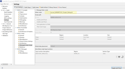

In my application I have to manage some pages of the external flash memory, I mean I have to read, write and erase data to/from it.
As you know, you have to locate in RAM the functions that execute the erasing and writing in flash, otherwise a system bus error occurs during the operations.
These functions are implemented in flexspi_nor_flash_ops.c and fsl_flexspi.c files, and, in order to move all these functions in RAM, I copied the linkscript folder.
Keep in mind that this procedure comes from the evkmimxrt1020_flexspi_nor_polling_transfer SDK example, and I spend a lot of time before understanding that the linkscript folder is mandatory to make the code work.
In my opinion, the best solution should have been to declare every function as  __RAMFUNC(RAMx), but here, in this SDK, someone decided to use the linkscript files insted.
I don't want to dispute this decision, that maybe is the most agile, but the linkscript folder in some ways is blocking my __DATA(RAMx) allocation.

  I checked your project again.
I think the linkrscripts add is the root isues.
As I compare the mapfile and the generated ld file, a lot of difference.
1. issue with linkerscripts:
2. no issue without linkerscript
3. ld compare result
Left is OK, right is the issue one
I think it is related to the ld file relatedship with the linkerscript file
I think, you can don't use the auto generated ld, you can modify the ld file, add the related file.o to the desired memory, then use the ld file directly like this:
Then, it will jump out of the ld file auto generation, and will make your RAM works.

OK I can use a the linker file that comes from a working project.
But If I move on this direction, how can I allocate all the flash functions  present in the in flexspi_nor_flash_ops.c and fsl_flexspi.c files inside the RAM? Have I to declare them __RAMFUNC() manually, one by one?
Regars
7,755件の閲覧回数
kerryzhou
Hi @riccardo_carlot ,
  Thanks for your updated information.
  No, you don't need to add  __RAMFUNC() manually,.
 You can refer the ld file directly, add the flexspi_nor_flash_ops.c and fsl_flexspi.c files .o to the RAM, just like this:

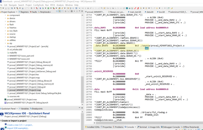

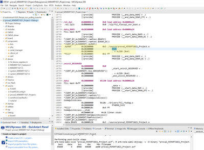

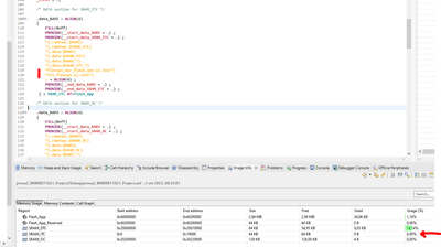

kerryzhou
   Thanks so much for your understanding.
   I already back to work and test your project.
  Let's still based on your first linkscrpt method.

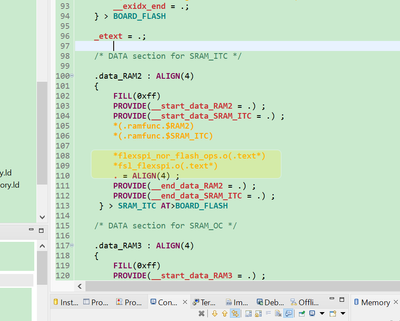

  I do it like this, then the data is in the related area:
You can see, from the map file, my defined vet2 array is located in the SRAM_OC area, it is located from 0X20200000.
I also attach my modified project.
You can delete the vet, vet1 method.

My problem, now, is: How can I allocate all the function in the flexspi_nor_flash_ops.c and fsl_flexspi.c  files in ram without manually declare them, one by one, as __RAMFUNC()?
In the project you just sent me, the linkscript folder is still present.
From this, please, remove the linkscript folder, clean and built it again. Now you shoud see the ITC_RAM empty. Isn't?
You will observe also that .id file will be overwritten every time you compile, despite everything I write (it's correct, MCUXpresso is set ot manage it).
Now, from this starting point, how can I allocate flexspi_nor_flash_ops.c and fsl_flexspi.c  in ram?
