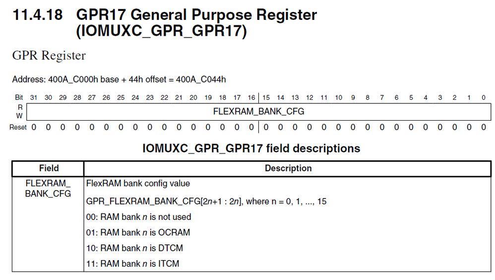

Based on the following explanation of the IOMUXC_GPR_GPR17 register:
The value that I need to load to the register is 0xAAAAFF55. Where the first  4 banks correspond to the 128KB of SRAM_OC, the next 4 banks correspond to the 128KB of SRAM_ITC and the last 8 banks are the 256KB of SRAM_DTC.

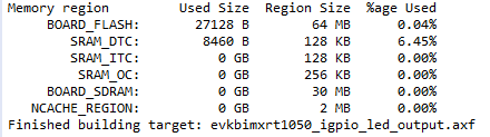

If you compile your project you will see the memory distribution that appears on the console is still the default configuration.

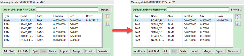

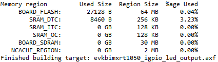

This is because we did modify the Reset handler to reallocate the FlexRAM but we haven't modified the linker file to match these new sizes. To do this you need to go to the properties of your project. Once in the properties, you need to go to C/C++ Build -> MCU settings. Once you are in the MCU settings you need to modify the sizes of the SRAM memories to match the new configuration.
When you make these changes click Apply and Close. After making these changes if you compile the project you will see the memory distribution that appears in the console is now matching the new sizes.

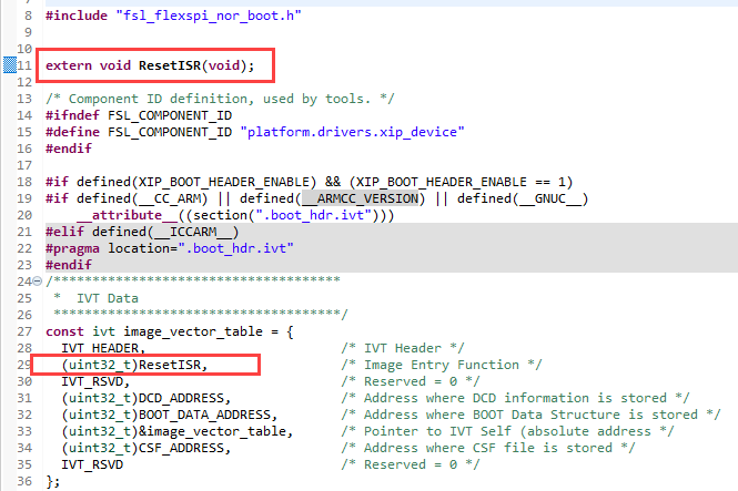

We need to change the image entry address to the Reset handler. To do this, you need to go to the file fsl_flexspi_nor_boot.c inside the xip folder. You need to declare the ResetISR and change the entry address in the image vector table.

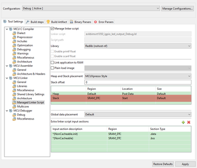

Finally, we need to place the stack at the start of the DTCM memory. To do this, we need to go to the properties of your project. From there, we have to C/C++ Build and Manage Linker Script.
From there, we will need to add two more assembly instructions in our ResetISR function. We have to add these two instructions at the beginning of our assembly code:
