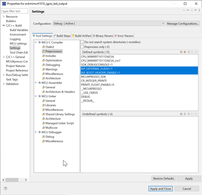

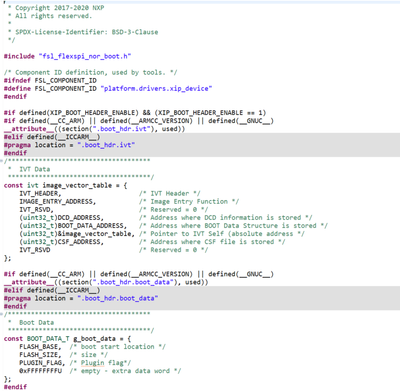

In order to add the IVT and boot data to the image you need to:
Right click on the project -> Properties -> Settings -> Check if the XIP_EXTERNAL_FLASH & XIP_BOOT_HEADER_ENABLE are set to 1
With this during compilation the IVT and boot data will automatically be added to your Image
Hope it help you!

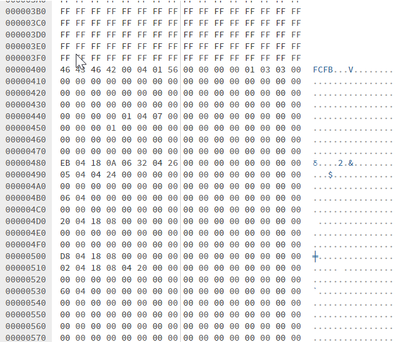

As you mentioned, the settings XIP_EXTERNAL_FLASH and XIP_BOOT_HEADER_ENABLE is set to 1. I've generated a binary file of evkmimxrt1010TOGGLE_igpio_led_output, and I will provide the link. I've used another example, flexspi_nor_polling_transfer, to transfer this binary file to external flash using file handling functions (fopen, fread, fwrite, fseek). I will also provide the binary file. When I turn on the board, the GPIO pin should toggle, which is my application code. However, that is not happening. Where did I go wrong? Are there any other settings that I should consider? Explain booting from external flash in detail.gpio.pnggpio.png

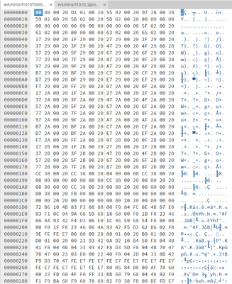

Looking at your binary file, I notice that it doesn't have the IVT and boot data in it. You can see in the image how your binary starts directly with the code, but in the binary with IVT and boot data starts with some FF and then the boot data.

In order to check if the binary is generated correctly you can go to the xip folder and check the evkmimxrt1010_flexspi_nor_config.c & fsl_flexspi_nor_boot.c files.
In these two files you could see how the IVT and boot data are generated, if XIP_EXTERNAL_FLASH & XIP_BOOT_HEADER_ENABLE are set to 1 the code on these files would be enable (not in gray).
If this is not the case, try to rebuild the project.

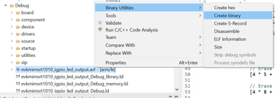

When the code is enabled, you can generate the binary going to the Debug folder -> right click on the .axf file - > Binary Utilities -> Create binary

I've generated a new binary file that includes the IVT structure at 0x1000. As you mentioned, the binary file starts with some FF and boot data, followed by the IVT structure. However, booting from the external flash still isn't happening. What could be the reasons for this?
While transferring bin file to flash I've written flash start address as 0. Is it correct?

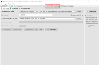

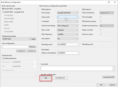

In order to check the FlexSPI configuration you can use MCUXpresso Secure Provisioning Tool.
MCUXpresso Secure Provisioning Tool | NXP Semiconductors
This tool will help you to generate a bootable image according to your memory.
In some cases, you would need to customize the FlexSPI NOR template that the tool provides because the SDK examples are made and tested for the EVK's memory.
Here are some steps that could help you to test the configuration for your memory.
Create a workspace, select the processor and go to boot memory configuration.
You will see a new window where you can select the configuration of the memory, once you finish the configuration you can check the communication with the test button.
If the communication is successful, you can write an image using the tool.
Refer to chapter 6.2 of User Guide - MCUXpresso Secure Provisioning Tool

What is the purpose of using the secure provisioning tool?
The tool will help you to generate and write a bootable image according to your memory, in addition you can check if you are able to communicate with the chip and memory.
There is another option of using serial port. Can we use that instead of USB?
Yes, there is an option where you can communicate your chip to the tool via serial port. But you can only use LPUART1 pins.

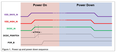

The first thing that happens when you boot your processor is the power-up sequence, if this isn't made correctly the processor boot could fail.
In the MIMXRT1011CAE4A the power up sequence is the following.

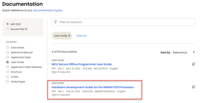

If you want to check more about the power-up sequence or any other hardware specification you can check the Hardware Development Guide from the RT1010 documentation page.

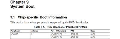

The next step is the boot mode, the boot rom will check the status of the boot mode pins to determine boot mode (boot from fuses, serial downloader or internal boot)
The way the boot mode works is the following.
Refer to
Chapter 9.3.1 of i.MX RT1010 Processor Reference Manual

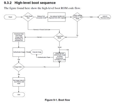

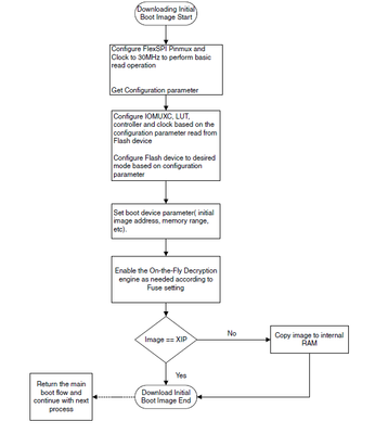

Then the boot rom will check the boot config pins, once the processor knows he will read the image from an external memory he needs to configure the FlexSPI in order to do so.
The steps that the processor does are the following:
Refer to
Chapter 9.6.1.1 of i.MX RT1010 Processor Reference Manual
Also, there is a video from the official NXP YouTube page where you can find some explanation about the boot options and some code examples:
MCU Tech Minutes | Boot Options for i.MX RT Crossover MCUs (youtube.com)

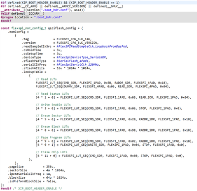

We've recently enabled the options XIP_EXTERNAL_FLASH=1 and XIP_BOOT_HEADER_ENABLE=1 in the settings. I'm curious about the necessity of activating XIP mode in the external flash. Additionally, I've noticed that these configuration bits are present in both non-volatile and volatile configuration registers. While I've been able to read these registers using the flexspi_nor_read() functions, I've encountered difficulty when attempting to write to them. If it is indeed necessary to enable these bits, could you advise on how to access and potentially modify them?

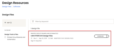

You may experience some trouble accessing the memory using SDK example/functions because the examples are made and tested for the EVK and you are using a different hardware, I recommend you compare the LUT from both memory in order to know if the commands are different.
You can find the memory from the EVK in the Schematic from the Design Files.
If the commands are different you would need to change the LUT in your code. You can use the following application note to see how you can check if the commands are different and how modify the LUT from your code.
How to Enable Debugging for FLEXSPI NOR Flash (nxp.com)
If you still have questions about this, please help me creating a new post with all the context in order to keep better track of Q&A.

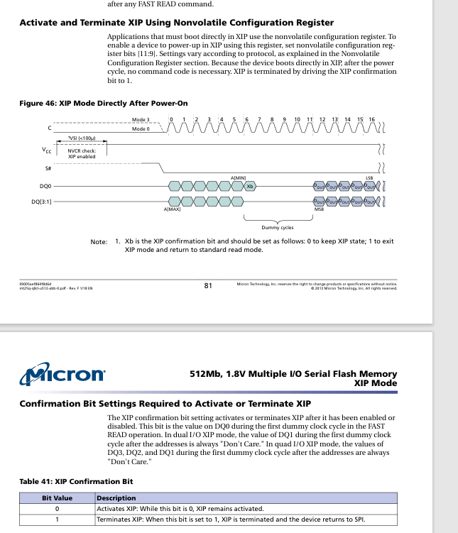

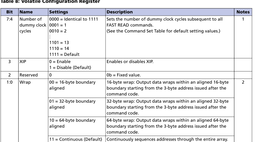

I've mistakenly changed the values of NON-VOLATILE configuration register. Now the flash is running in XIP mode instead of SPI mode. For deactivating XIP mode, flash device datasheet mentioned particular procedure which I'll provide below. How to send the bit on DQ0 on first clock dummy cycle? NVCR.pngNVCR.png
10,575 Views
Pablo_Ramos
Please help me creating a new post for these new questions with all the context in order to keep better track of Q&A.
