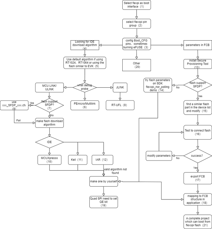

The following diagram is the flowchart of the entire flash enablement process. In addition to the early hardware design, there are mainly two parts. One is the flash download algorithm for IDE; The second is the flash configuration header FCB in the application. Once these two are completed, one can officially enter the application development process of the project. As for flash encryption, multi-image startup, and so on, they are all very later matters and have nothing to do with this article.
The serial numbers in the flowchart represent annotation and data index.

  1. The way to tell the bootROM/flashloader how flash is connected is setting BOOT_CFG pin or burning eFUSE. Thus bootROM/flashloader can know where to read the FCB before the user program starts. FCB refers to Flash Configuration Block. The FCB position of each RT chip may vary. The FCB position in RT10xx is generally at the 0 address of Flash, while the FCB position in RT11xx and RTxxx is at 0x400. In short, the startup process is to first read eFUSE or BOOT_CFG pins by bootROM/flashloader to get where the flash is, then reads the configuration information of the Flash from the FCB using 30MHz single line SPI mode, and then configures the Flash. After that high-speed execution of user program in Flash is supported. BTW, bootROM and flashloader are different things. In RT10xx, bootROM connect with sdphost.exe to download flashloader to SRAM, and then flashloader connect wtih blhost.exe to do other works. This is called serial download mode. In RT1xxx and RTxxx, bootROM connect with blhost.exe directly. But flashloader is still needed.
  1. To download the program to Flash for debugging and execution, you need to download flash algorithm first. The download algorithm for different flash devices are likely to be different.
  1. RT1024 and RT1064 have already embedded a third-party flash die, so their algorithms are ready-made and already available in the demo in SDK. Additionally, they cannot be started from other external flash connected.

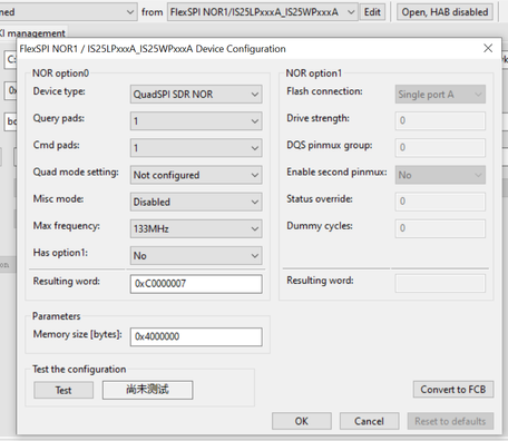

  1. NXP officially recommends the Secure Provisioning Tool (SPT). In addition, the NXP-MCUBootUtility, which was born earlier, has almost the same functionality and is also constantly being updated.

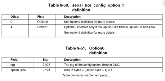

  1. If SFDP is supported, it would be easier to handle. I.MX RT's bootROM supports simplified configuration of flash. By input one or two word configuration words, the bootROM can automatically configure with flash. The meaning of configuration words can be found in the system boot chapter of RM.
Both SPT and MCUBootUtility configure FLEXSPI in this way. Users can select similar models in the menu and modify some parameters. These parameters will eventually become option0/option1 and be passed to the bootROM.
  1. Click on the Test button in the figure above and pray it can pass. If it doesn't pass, modify the parameters and try again. Sometimes it's really can’t configure the flash by simplified way, so you can only use the "User FCB file" option and specify one for it.
  1. Click the "Convert to FCB" button to export the binary file of FCB. This bin file can be used in the future to create complete images for download. There is also a great use here to reverse to flexspi_nor_config_t structure.
