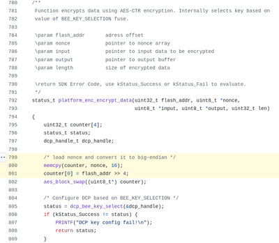

I usually compute the ctr_nonce for BEE taking the nonce[127-32], and in the LSW I put address r-shifted by 4.
This is confirmed by documents [redacted] and also by code provided by SDK examples:
I usually use SW key or SW_GP2 key, and this simple algorithm make BEE works well.
However, I found another algorithm, significantly more complex:
[Redacted]
I wonder when this algorithm is used by BEE, and I would like more details on how H7 and H8 are used, because it is not clear from the drawing.

However, I found another algorithm, significantly more complex....
@mastupristi What is your purpose? Please tell me the source of this screenshot, NXP's publicly available information has listed what can be disclosed.
