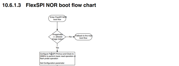

Hello @carstengroen,
In your first question you mention there isn't a PAD control command for this pin, could you clarify what do you mean about this?
About your second question, the pinmux for the FlexSPI is configured insite the bootROM as it mention in the following flowchart:

Regarding item 2:
I am aware that the pinmux for the FlexSPI is configured inside the bootrom.
But, why are the _PAD_ commands issued in the DCD structure then (there is no corresponding _MUX_ command for these 4 pins in the DCD data, only the _PAD_ commands)?
In the DCD data:
/* #1.124, command: write_value, address: IOMUXC_SW_PAD_CTL_PAD_GPIO_SD_B2_02, value: 0x08, size: 4 */
	0x40, 0x0E, 0x84, 0x00, 0x00, 0x00, 0x00, 0x08,
	/* #1.125, command: write_value, address: IOMUXC_SW_PAD_CTL_PAD_GPIO_SD_B2_03, value: 0x08, size: 4 */
	0x40, 0x0E, 0x84, 0x04, 0x00, 0x00, 0x00, 0x08,
	/* #1.126, command: write_value, address: IOMUXC_SW_PAD_CTL_PAD_GPIO_SD_B2_04, value: 0x08, size: 4 */
	0x40, 0x0E, 0x84, 0x08, 0x00, 0x00, 0x00, 0x08,
	/* #1.127, command: write_value, address: IOMUXC_SW_PAD_CTL_PAD_GPIO_SD_B2_05, value: 0x08, size: 4 */
	0x40, 0x0E, 0x84, 0x0C, 0x00, 0x00, 0x00, 0x08,
I hope I explained it better this time
