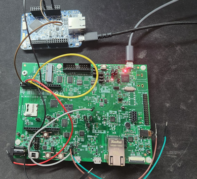

We observed an issue with MIMXRT1060-EVKB:
We flashed the sample software provided in the MCUXpresso SDK, the LED toggling project (evkbmimxrt1060_igpio_led_output).
Connected the 3.3V externally to pin 8 of J16.
Then connected the mini-USB port try to power up the board
The board stuck, the red LED D6 and D1 are always on:
The reset button(SW1) does not work in this case.

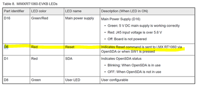

Checked the user manual, the D6 means:
But have no idea why that 3.3V connection could result in a reset via SDA
The only way to get rid of this state is to cut the power (unplug the USB), disconnect the 3,3V external input to the J16, plug in the USB again, the board can power up and LED starts blinking. At this time, if we plug back the external 3.3V to the J16 pin8, it seems fine and no issue.
The problem is if we have 3,3V connected to J16 before the EVKB is powered, then if we connect the power, the board will stuck in the state shown above.
